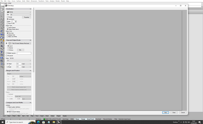

I have solved it, article on internet about spooling list.
https://answers.microsoft.com/en-us/windows/forum/all/deleted-printer-still-showing-up-as-printer/7a68da87-f433-4cdb-942f-c5e736e53606
HOWEVER still the visual issues.
  1. select pdf24 and we get this:-
then try v7 and also same problem
then try pdf24 fax and it shows ok
then try for pdf24 again and we get this
it will however print a landscape, and offers quality choice combo list. and result is EXCELLENT. no streaks,
so try Msoft print to PDF
but NO OPTION to select quality at all, and the result is suffering artefacts, high compression, a mess.
gives pink streaks on pale grey.
so whats going on ?
