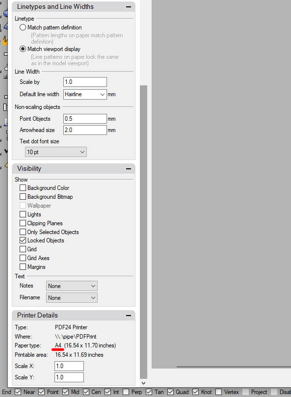

I have come to continue my plan making from 5 months ago, having rebuilt PC to win10 64bit pro and installed all my softwares and latest versions etc, and first use of Rhino again, and deciding to continue with V5 just to see all is as before.
HOWEVER I select print and use my trusted PDF24 prog as before, the layout view is only part showing yet its A3 and I have chosen A3 and also 1 to 1 scale.
…and after trying some other settings such as window and also extent, going back to layout option, now its just a grey area, i.e. screen is a solid grey to right of the print dialog menu, then choose A4 and I see my items, but half only as one would expect, choose A3 and the A3 layout does not appear, I cannot get to happen what has always worked before.
I reboot PC and go back in and all is grey.
not sure why it says A4 16inch !
I try for window >set and position the A3 perfectly on the layout then hit enter and back to a grey screen :weary:
I try portait and see image, select landscape and now get this, it wont go landscape !

Do you have this checked?
Hi, No, only locked objects checked.
