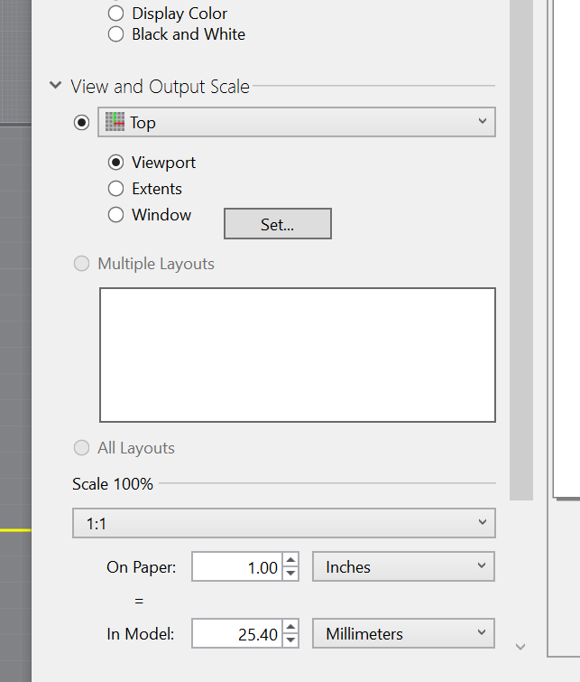

select 3.0089 inch wide object, export as pdf, open pdf in photoshop, use default settings, measure width,
its 2.382 inch.
try again, same.
try for .ai but pshop says cannot parse.
How should I get something into photoshop and retain size ?
I have used pdf before, I have also found that some parts of the project get repositioned and overlap other items when I open into pshop.
I am using export to pdf again, I have drawn a speech bubble on an A5 portrait shaped art, its 3.8cm wide on a 14.79cm wide artwork.
select it, go file export selected, choose pdf, make sure scale is 1:1, I see a minute version of the entire art and speech bubble, within a white portrait shaped space. I export it as pdf.
Open the pdf in photoshop, 300 dpi, drag onto the A5 artwork 300dpi and its minute. Its brought in the speech bubble, the artwork it sat on and the two rhino dims, all is a mere 2.41cm ! wide, yet I only selected the speech bubble.
tried three times.
Why if I choose 1:1 with the artwork measuring 14.79cm wide in Rhino does the artwork as well as the selected speech bubble get selected when I select just the speech bubble and why is it NOT. 14.79cm when in photoshop.

How do I get artwork from Rhino into Photoshop same size ?

No idea, but I just imported a Rhino 5 pdf export into Photoshop 6 and the image is sized exactly right. I didn’t do anything with the settings, it just worked first time. So it can be done…
