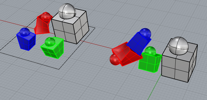

Is there orient on cplane?
I mean as easy as in slicing softwares. Just one click on the product surface and the model is on the sheet, chosen surface face down..
Now I use orient 3 points and it feels maybe not the best way to do it.
Dont want to build any extra squares on cplane just for that…
Thanks :slight_smile:

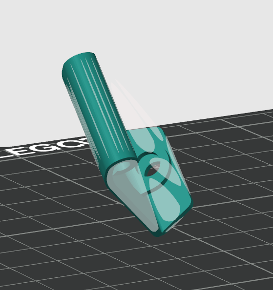

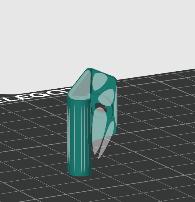

What is great in slicers, is “Lay on Face”.
Just use command and 1 click and and the correct surface is on the sheet.
kuva
It would be great also in Rhino, just write the command and click the surfaces…

With orient 3 points it takes 18 clicks to get these three (colored) parts to the same CPlane (world) as the assembly next of them.
In slicer it takes 3 clicks. That is a huge difference.
Should be like, pick surface, pick surface, pick surface, press 0 (or enter), and all the parts are on cplane. Totally 4 clicks vs 18 clicks…
“Now it takes 60 clicks when using orient 3 points” I meant if you have 10 parts and want them to the same cplane (orient 3 points). Same 10 clicks in slicer.
