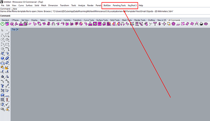

Apologies for commenting on an old thread, it’s relevant though. I opened Rhino today and my T-Splines drop down menu has gone?
Not sure how to get it back, the toolbars etc work fine
Hi Andy - is there a .ruibak file where the tSplines rui file is ? If so, you might try renaming and loading that one, though it may already have been overwritten- worth a try.
Hi Andy, did you read a thread about missing toolbars . John explained that letting a computer hibernate while Rhino is open , is not good practice. I wonder if anything would apply in the missing t-splines toolbars. Might be good to read it. ----Mark

I don’t hibernate the desktop but sometimes I shutdown and let windows shutdown programs if I’m in a hurry - it could be the same thing?
