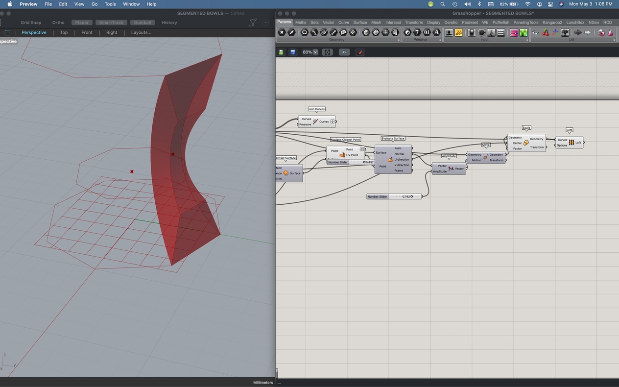

I am picking my way thru this like all new grasshopper people. I have made some real progress, with sale and loft, but ultimately what I am trying to achieve is a clear window on the inner tampered area similar to what I was doing with triangles on a planar surface. i am having difficulty with the offsets because the surface is non planar. Also I am confused on why and when you need to specify a domain. And completely confused by the Random node? How does that work. Also how do you esport a grasshopper file on this format. Like when people respond they respond with a script I can directly input into Rhino?
I am only able to include screen shots, would like to be able to post directly the script I am working on.
Thank you in advance for help and all your help. People are terrific on this forum.

There are ways to do this, even on a concave, curved surface like this. Could you be a little more specific on how you want the hole to look?

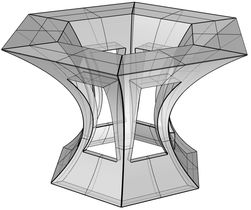

Thanks for your quick response. I managed to get the hole like I want it. But I need to create a wall thickness. Offset surface does not work. Neither does scale. I am now trying to convert to mesh and use mesh thickening. What do you recommend? This is really pretty close to what I am after. I am creating table bases with individual printed modules like below will be one part of the polygon. The non planar surfaces are hard to manipulate as geometry. I am being a 3d printer so I am exploring ways to print larger shapes. I have my own shop.

It depends on how you want it to look. I mean mesh thickening potentially works, but all it does is thicken in normal direction of each mesh face.
To achieve this you can connect the Faces ouput of the DeBrep (Deconstruct Brep) to a SMesh (Simple Mesh) component. This will give you four quad meshes that you then need to join and weld before thickening!
An entirely different approach could potentially be to start from a rough, low-poly, closed brep (i.e. polysurface) - for instance a cube -, and chisel out the window and curved sides with negative geometries. This would be a subtractive approach, like sculpting in wood or stone, where you start with a blank.

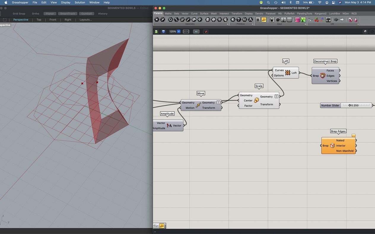

Speaking of the last non planar polygons I am working on. I finally got a quad ramesh to be smooth. It looks really good, but when I went to apply a mesh thinking it did not hold up the joints did not hold up and look torn. Impossible to offset the surface because they are not joined, and even with a merge component they remain different surfaces. I had a really nice form and mesh thickening when without the severe bend in the curve.
I took the entire thing a part and went back to the original geometry, to apply a radius to the polygons. But when I went to explode it. The surfaces would not separate into separate faces, probably because of the radius to the polygon. I quit at 2 am, so I will have to re look at it when I am finished some other tasks today. I am basically trying to put together a kit of geometries that are open and geometrically interesting to form a puzzle into furniture. I am pretty excite about it. I will post my results when I am happy or when I run into a wall and need help.!!

Here is my starting script. Maybe look over it and see if can be improved. The idea as I said before is to print segments and combine. Consider this a rough draft. If you work the sliders for the polygon radius you can see the different forms. It is a side table, to go by a sofa.
FranSEGMENTED BOWLS.gh (46.2 KB) SEGMENTED BOWLS.3dm (2.7 MB)
Here’s how I would probably do it without meshes, since the goal is fabrication.
Meshes have less dimensional fidelity, but better performance!
You can define the upper, middle, and lower thicknesses individually. The hole is cut out.
I’ve slightly chamfered the edges for a more realistic look, but this is quite slow! I’ve made it optional in the definition. I can be toggled on or off. Off is better for dialling in the shape-defining values. Otherwise, the chamfered edges get recomputed at each iteration.
explosion
Apart from the geometries being polysurfaces now, the only other difference between yours and mine is that the faces - where the individual modules meet/are connected -, don’t intersect anymore.
