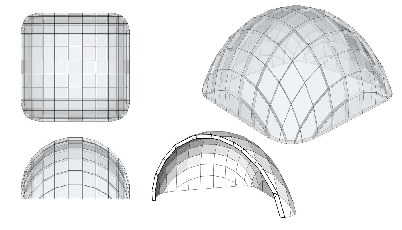

I want to create a freeform shell from a material with a thickness (e.g. polyurethane triangular cells). I’ve found many plugins that can create tesselations with planar cells on freeform surfaces(panelling tools, lunchbox, kangaroo) but so far I haven’t found a way to make a tesselation that meets the demands to create it from a fixed thickness material. I am willing to put in the effort to study in order to achieve the result that I want but
a) I don’t even know if it is mathematically possible (I would bet yes)
b) which tools I should invest in mastering.
I am explaining my objective more thoroughly in the following image.

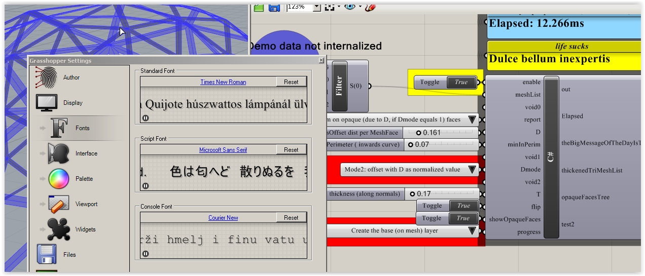

Note: if you are crazy about order on things use Times New Roman as Standard Fond (if Rhino crashes there’s other ways to do that by editing the Kernel xml file) other wise the C# and the parameters would end up in an ugly topological mess (I hate that):

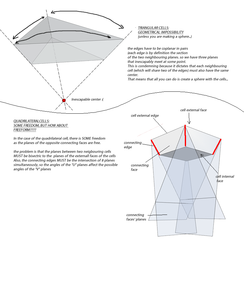

But I seem not to have made myself clear: giving thickness is not a problem. the goal is to make something fabricable from polyourethane slubs (we are talking about a thickness of 50cm or so in order to be able to fabricate a pavilion by just cutting correctly the sides of big slubs.
Nevertheless, by trying to explain my goal, I have come to understand it better myself. I’ve so far found that it really is impossible to achieve it with triangular cells (with the given restrictions all you can make is a sphere)
Now I am researching quadrilateral cells, that give a bigger freedom but still I am feeling that I’m trying to reinvent the wheel. I hope somebody who has delt with this issue could post something.

You’re missing the point man, the whole point of this is to find what one can create using fixed thickness slubs.
If I find it can give versatile results I plan to construct a modified cutting machine. The idea is for it to be assembled like an igloo… So far I’ve made a few experiments with quadrilateral cells and it seems to be working (I did them in sketchup as I am not sure yet what conventions I should follow in my definitions so it is easier to experiment there by using intuition)
There’s a whole sub-field within Architectural Geometry that focuses on mesh offsetting under fabrication and aesthetic constraints. Helmut Pottmann and his work would be a great starting point here.

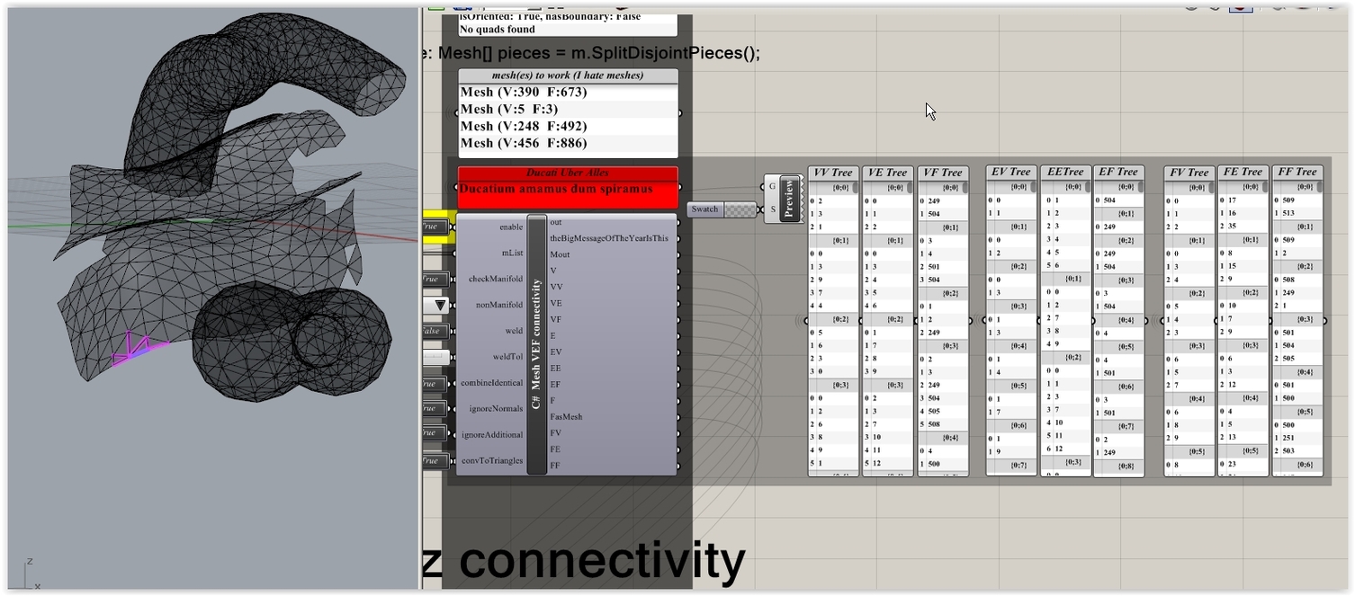

In the mean time I’ll mail you the thing promised (Includes: mesh connectivity trees (9 since we have vertices, edges and faces = 9 combos), face dihedrals, clash defection and most importantly what superbike/car to buy) AND the notorious BigBang case to test all the above … where big bang things happen (and then this, this and that):
BTW: Forms (and finding the Truth Out There) are OK(?) if you like that kind of stuff … but there’s the 1B question (in order to get the gist of what’s happening in the forthcoming material): Are you 100% familiar with connectivity trees? (lot’s of people they are not).

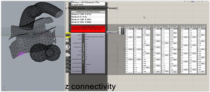

We have 3 sorts of animals in a mesh: V(ertices), E(dges) and F(aces). Exactly the same we have in Breps.
Due to that there’s 9 possible combos - meaning 9 trees… Enlarge this captured image (deals with Mesh Lists and NOT a single Mesh) and enjoy 9 freaky Trees with indices (but what they mean? You tell me). Are you OK with similar stuff? (not to mention DataTrees in general).

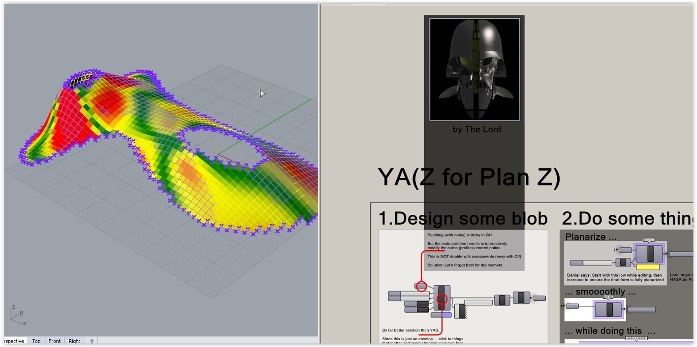

Get this ancient Kangaroo2 thingy (newer K2 builds may require replacing the solver) and answer all your questions at once. Of course I have it in a far more modernized version (only one C# , less is more) but … well… ancient things are always better than modern things.
YAZ_kinda_demo_V1.3dm (172.0 KB)
YAZ_kinda_demo_V2A.gh (145.6 KB)

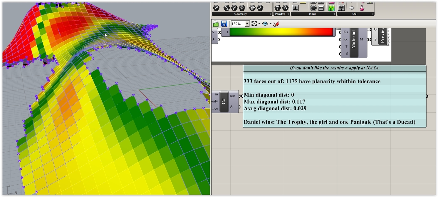

Also Peter, you keep talking to me about approximating planarity… I am asking what you can do IF you take planarity as a given. Which are the attributes of the surfaces that can be constructed this way… (Not by approximation but in the strict, Platonic sense) I’m still in the process of reading all these books I’ve found. Once I understand I will post whatever I find to save any other newbies like me from their misconceptions!
Get this (no cross/dot stuff implemented on purpose) and think: what could be the algorithm in order to find the right dihedral? (play with the flip stuff as well). Meaning: how we could declare a face/face relation as convex/concave? (in relation to what?).
Mesh_dihedrals_DemoEntryLevel_V1.gh (119.3 KB)
BTW: Planarity (quads and higher) is a given only in Planet Utopia (and/or Zorg). Don’t been trapped in that rabbit hole (many entries, no exit). In the V2 of the attached def we’ll see some stuff on that matter.

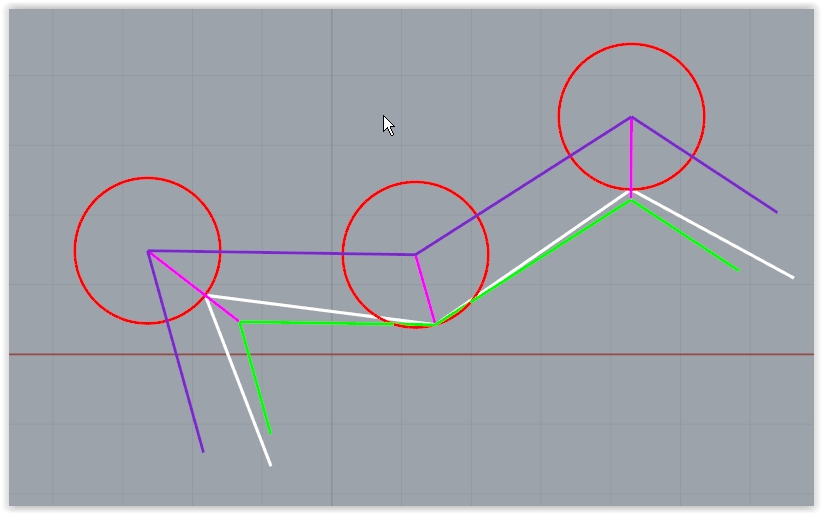

    5a. Unitize each normal and multiply by T. Move vertices (4) - vertex + vector - and make the offset face. That does the thicken def that I’ve posted already here. The white line in the sketch.
    5b. Let’s talk about the green line: for each vertex get the adjacent faces (via VF as in 2) and find the intersection of a line (from vertex and direction the normal) VS an offset mesh face plane (T) . Compare the ccx points. Are equal ? (within tolerance). If they are why we are talking about face/face dihedrals? Because they describe the taper angle, that is. If is too small … it’s realistically impossible to do any piece in real-life .
See this simple sketch (some abstract section) for distinguishing 5a from 5b

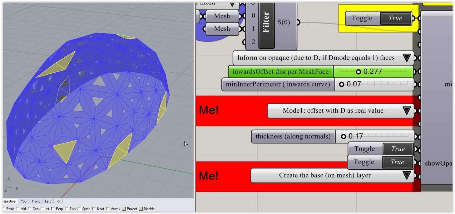

In the mean time found 10 more minutes for some changes on the ticken tri mesh List thingy
TriMesh_thickenWithHoles_V2.3dm (245.1 KB)
TriMesh_thickenWithHoles_V2.gh (136.8 KB)

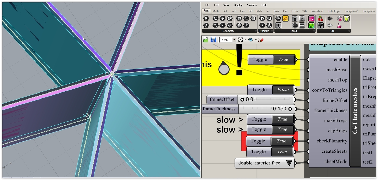

  1. result: controls if one mesh or pieces are made
  2. tMode: controls if equal thickness things are made (base to top: planar, distance T)…

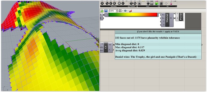

  3. Planarity Check: gets the diagonals per face and per tapered sides (if result = pieces) and performs the classic planarity check (min diag distance) according the planarTol value (remember: we are not in MIT, we are sharks after dollars). For instance see this check on the demo data:
Now … if for that random (not relaxed via MeshMachine) blob thing 80% of the pieces have planar tapered sides (within 2 cm tolerance = absolutely nothing in big things [no glass] and real-life) … should you spend your time chasing chimeras AND the truth out there ? Not in a billion years (otherwise apply at MIT ASAP).
Even If I geared K2 for some simulation/“relaxation” on that matter (not that difficult, in fact I have stuff that does that but is rather slow) it could be 100% Academic since the main issue here is that you can’t do the tapered task by hand … meaning that if CNC/3D printing is on duty … why bother talking in the first place???

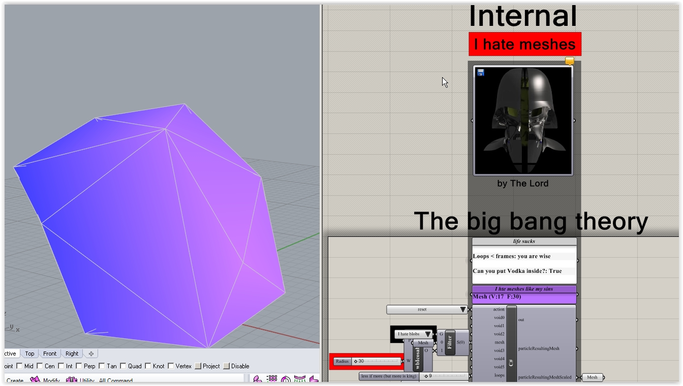

In the mean time let’s play with some strictly internal stuff (not for public eyes, that is).

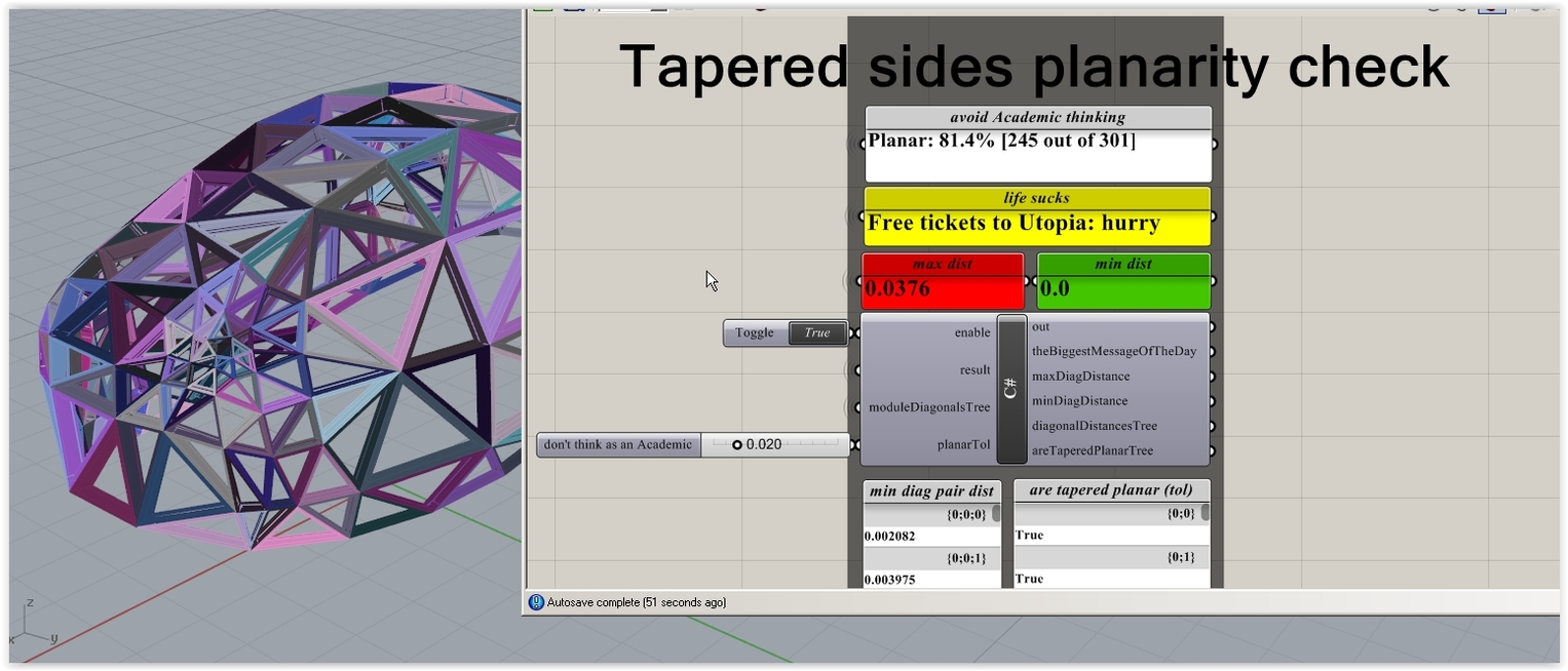

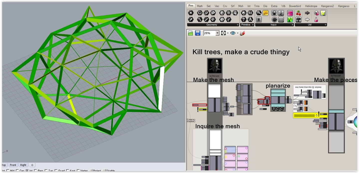

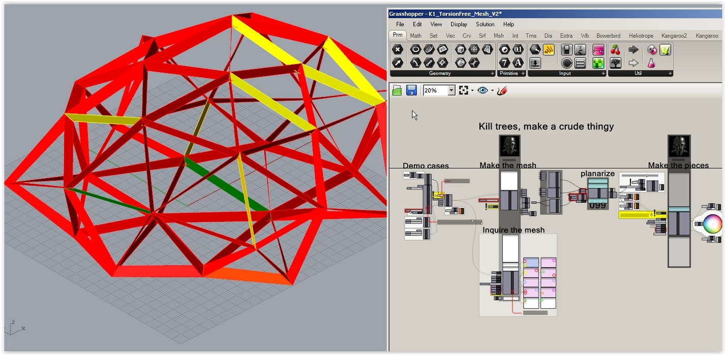

See this? Reds are not planar tapered sides (base/top faces are not on display for clarity):
See that? Greens are planar tapered sides. How this is made? Who knows? (and who cares?). He he:

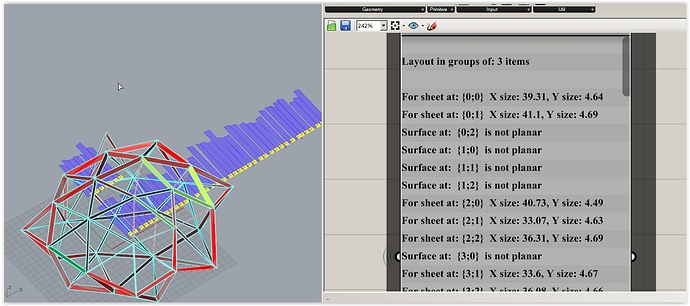

And some other stuff as well (production layouts and some detail [plywood frames]):
And doing a production layout without the planar fix part (non planar stuff is rejected).
