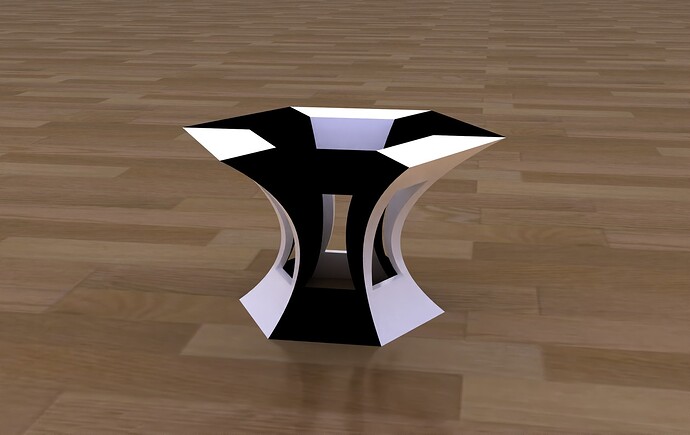

I did a rendering. The scale is off but I think it is very cool looking as a table and printed piece.
Fran
Please send me a picture of a printed module. I absolutely want to see such a giant print, especially if it’s in plastic. :slight_smile:
I do not have the printer yet, and I suspect the surfaces will have to broken up more with a mesh or hole patterns. Look at the films and photographs of the printed objects on the WASP printers.
The 3d printed chair was printed using wood/resin pellets and takes a week to print one!! Large surfaces have to be mitigated with grids, patterns and meshes. That is why I put the windows in. I just have to test and see.

As the Wasp is also a FDM-printer I feel pretty confident to say that the diamond grid pattern on the chair surface was probably more of a design choice than it has to do with the 3D printing process. Doing it this way, it did probably take a little less long to print, than printing a closed surface.
The chair also was probably not printed in this orientation (if it was done with FDM on the Wasp), because that would have taken lots of support material, speaking in volumes probably even more than needed for the chair itself.
If you flip the chair, so that it’s open backside would sit face down on the print bed, you could possibly print this with very little or no supports at all.
The excessive use of support materials should be prevented! It unnecessarily increases print times, lots of plastic waste is produced that somehow will end up in the ocean and degrade to micorplastic, which then finds its way back into us with the consumption of fish. Supports take a long time to remove and the model needs to be post-processed to remove marks, spots, and other imperfections, which takes even longer.
Minimizing the use of supports, means being aware of the intricacies of the 3D printing process, the limitations of the printer, the material, etc. already in the design phase. The downside to this is that it obviously limits you in the design choices you can make, but that counts for everything that needs to exist in physical form at some point.
The window is probably more problematic than useful in terms of 3d-printing. :wink:
You could print each module of the current model as is, since the overhangs aren’t too bad, but the window would definitely need supports (blue) for the upper portion.
You can’t print without anything beneath! It’s true that when printing in plastic you can do bridging, but not over distances like this. You’d need to modify the geometry of the hole, at least the top part to be more 3d-printing-compliant. :slight_smile:

I agree… an elliptical hole could be printed without support material in this case.

I would never use inserts!! never. I do not need to. As I said I can fabricate steel/plastic hybrids. I can print the same in half on its side with the opening and place a 1/4" metal panel waterjet cut with inserts to attach to the plastic. Just one way of many to figure out openings.
