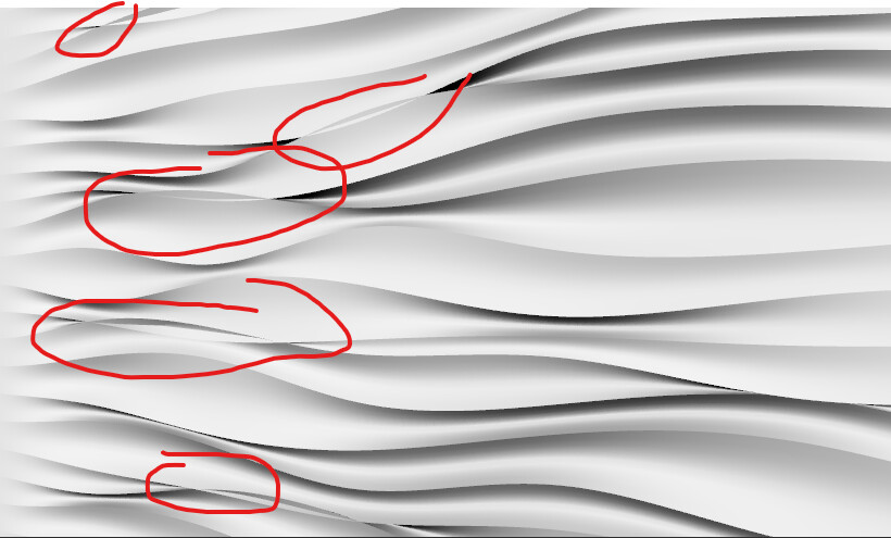

goal is this king of geometry, hoping to have it parametric.

This is pretty amazing patch you shared:
it has an issue of overlaps, I need it tangent, no overlaps.
and ill still need to figure out how it work so i can increase the amounts of wobbles per line.
Here is a thing - using the pairs of curves from your other thread:
waves_2021Jan15a.gh (28.0 KB)
It probably won’t do well with intersecting curves (used as rails for Sweep2).
