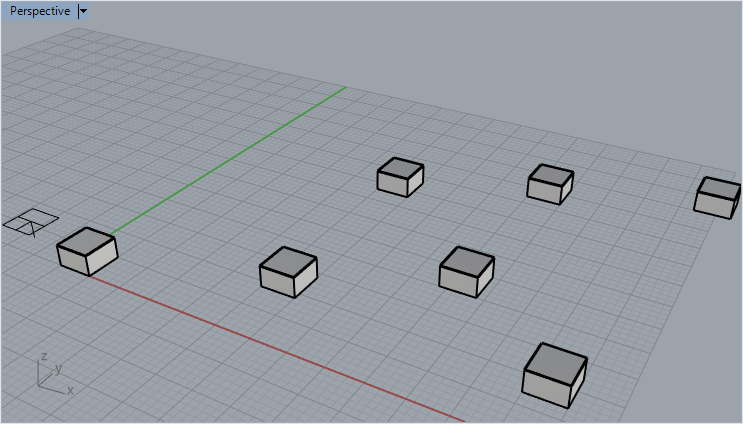

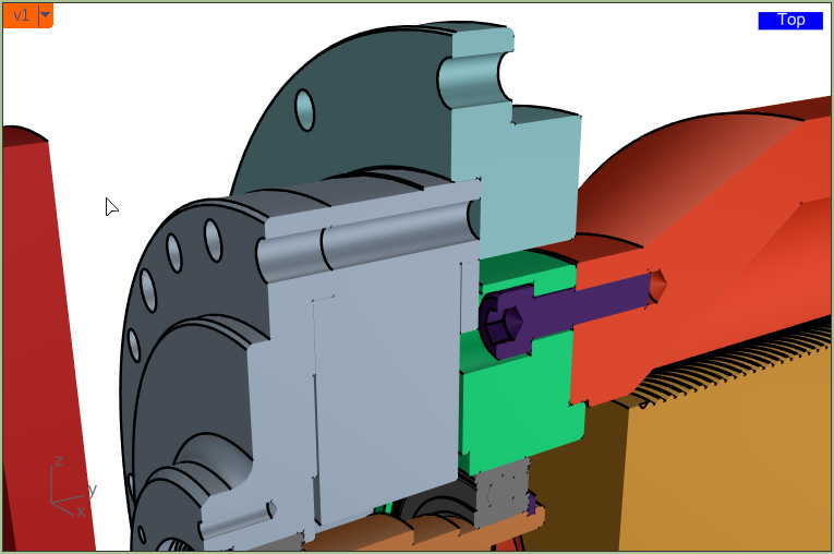

Objects are missing cut edges when clipped outside visible area
As you can see in the image below, the first box was cut by the clipping plane while it was visible in the viewport, wile the second one, which is missing the edges, was out of the view when the clipping plane cut it. Once I move the camera and I bring it into view I have to set the display mode to shaded again for the edges to show up.
It would be very useful to have the edges show up automatically.

Hi Jeff.

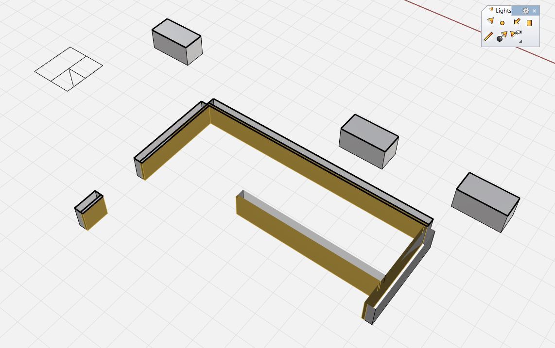

This is not entirely fixed. Objects inside blocks still have problems.
The cut edge for objects inside blocks is missing when they are not in the view when the clipping plane is created. (same as before)
Also the cut surface is missing for the boxes inside blocks.
Geometry outside blocks seems to be fine.
(6.0.17136.10381, 16/05/2017)

This would be useful for architectural design since wall types and thicknesses change constantly according to fire,sound requirements, finishing etc etc. Doors and windows the same, they already come as blocks when imported from Revit.
For this reasons it is very convenient to work with blocks and to see them sectioned in 3D and in 2D for plans.

Hi @jeff . I still have the same problem. If i create the clipping plane when the blocks are outside the view, when i move the camera and i bring them into view the cut edges and surfaces are not showing up.
(6.0.17150.8211, 30/05/2017)
@Bogdan_Chipara even after you release the mouse? Do the blocks already have their render meshes created?
I guess the best thing to do is to post a file here, with exact step-by-step instructions…because I’m just not seeing the problem here.
Ok, here are the steps:
  1. switch to shaded
  2. maximize perspective mode
  3. create a box and block it
  4. copy the block instance around several times
  5. zoom in so only one instance is visible
  6. add the clipping plane
  7. zoom or pan using the mouse to bring all the instances into view. (the other instances are not displayed correctly)

Ok, I installed release of today and I also reset the display modes.
The issue got fixed for blocks with the steps described above.
But the bug persists in other situations:
  1. switch to shaded
    ( the blocks are now showing up correctly)
  8. zoom in again so only one block is visible
  9. double-click on it to open block edit
  10. switch the box inside the block from Shaded to Ghosted and close block edit
  11. zoom out again to see all the blocks
    (the blocks which were not visible in the view don’t show up correctly)
    (6.0.17157.8191, 06/06/2017)
Hi Bogan - thanks for the blow-by-blow, I can repeat this exactly as you describe.
For now, if you move one of the block instances the display seems to correct itself.
https://mcneel.myjetbrains.com/youtrack/issue/RH-39675
The problem is only related to Ghosted.
I switched back and forward between other display modes but they seem to work fine!
