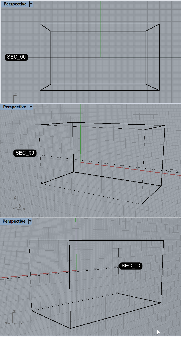

So, for whatever reason now, when I try to use SectionTools to “view section” in viewport, I’m not seeing the Crv that outlines the section.
Anyone? On a new show and really need to fix these oddities.
Thx!
Alan - is this somehow related to the previous problem? Does this one manifest itself on both the laptop and the desktop? Is this only with SectionTools now? It’s hard to tell what’s going on there…
@rajaa - any ideas?
Yeah, I kept it in this thread because I thought maybe it was related in some way.
@Alan_Farkas I see that in perspective the lines of the section are not continuous. We’ll have to check if we changed something with the clippingplane display that affected the quality of curves that happen to be located right on the CP.
Maybe @jeff has some thoughts? Looks like parallel viewing is fine, but looking at the curves from front and back both are affected in perspective per the image below. Note that I use VMWare.

@jeff I think the problem only appears when using SectionTools plugin. The image I produced with simple box and one section uses a simple section (run stCreate), then clip using stViewSections command (only Clip=Yes option). At some point when V6 was released, it used to work, but now it does not display properly.
Here is where you get the latest SectionTools plugin: https://www.rhino3d.com/download/sectiontools/1/wip
@rajaa But I can’t tell what I’m looking at in your image(s)… All I see are a bunch of lines, some dotted, and a box… I have no idea where your clipping plane is, or what things should actually look like… Until I can reproduce the “problem” here, I will not be able to suggest possible workarounds, much less fix it.
I will try reproducing it with SectionTools…
