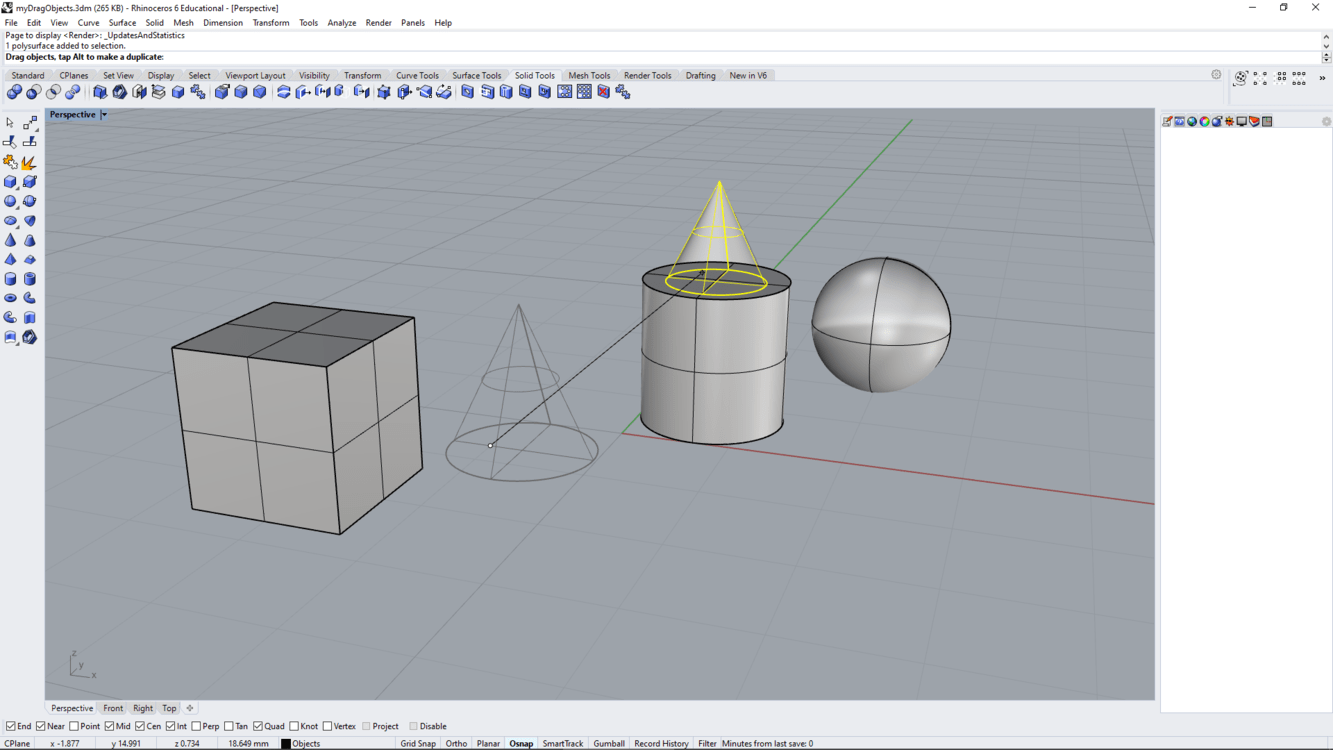

I have uploaded a screenshot of the situation. Numerous Osnaps are chosen, and the Osnap box is showing. But no object snaps appear.

So back to the main point, no, the object snaps are not showing. They do show if I have first selected the object and then I grab it. However, for example, if I just grab an object and drag it, then the object snaps do not appear. But perhaps that is the way it is supposed to work.

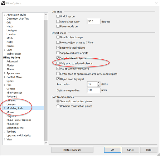

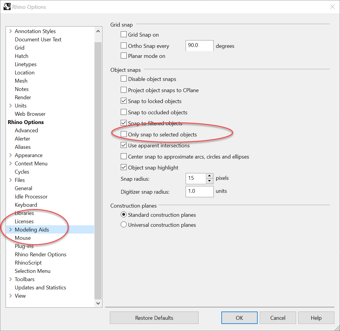

Hi Stanley -
check this setting to be sure:
