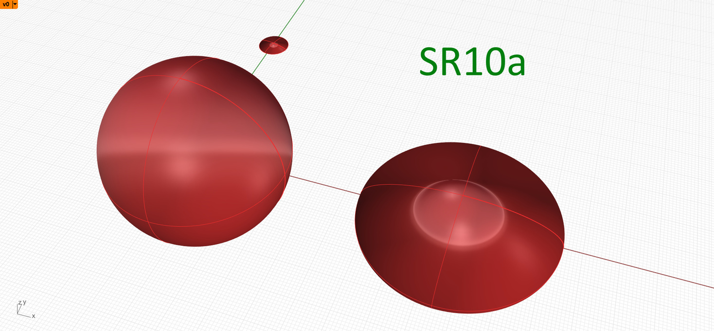

not directly a pitfall, but in V6 non-uniform scaling of blocks still breaks shading normals in the viewport:
https://mcneel.myjetbrains.com/youtrack/issue/RH-46983
@dale - any chance this gets fixed soon?
I’m not seeing this. Perhaps you can provide a file that demonstrates this?

here a file: blockShaderBroken.3dm (244.0 KB)
but the issue is documented in the tracker - just no one is working on it…

Dale was most likely running an in-house version of SR12 when he said that he was not seeing this.
I have now downgraded to SR10a to check this issue and this is the result:
So, it appears that this has been fixed in the meanwhile - you could install the following daily to confirm this:
http://files.na.mcneel.com/dujour/exe/20181127/rhino_en-us_6.12.18331.22291.exe
