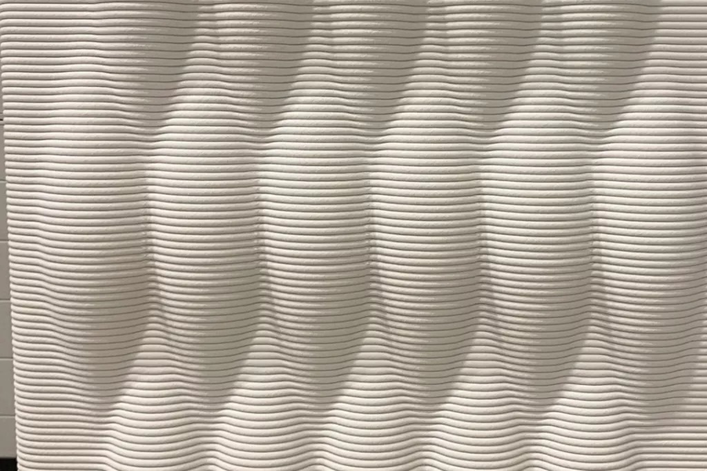

Hi i am working on parametric facade but i have basic knowledge on it can you guys help to sort out this
some of the images i am working on can you please send grasshopper code
regards
shailesh

Hi, something like this can be achieved by inflating (Kangaroo) or even over-smoothing a diamond or hexagonal pattern. If you also want to emulate the layer lines, it would probably be best to do that with a texture or shader.

thanks quan li but i need on the rectangle not circular to make a facade
i tried with diamond panels still i didnt get that texture
if by texture you mean the 3D-printed grooves, I probably would use a bump or displacement texture instead of modeling them.
Modeling can be done but if it’s for vis, it’s a bit of an overkill
