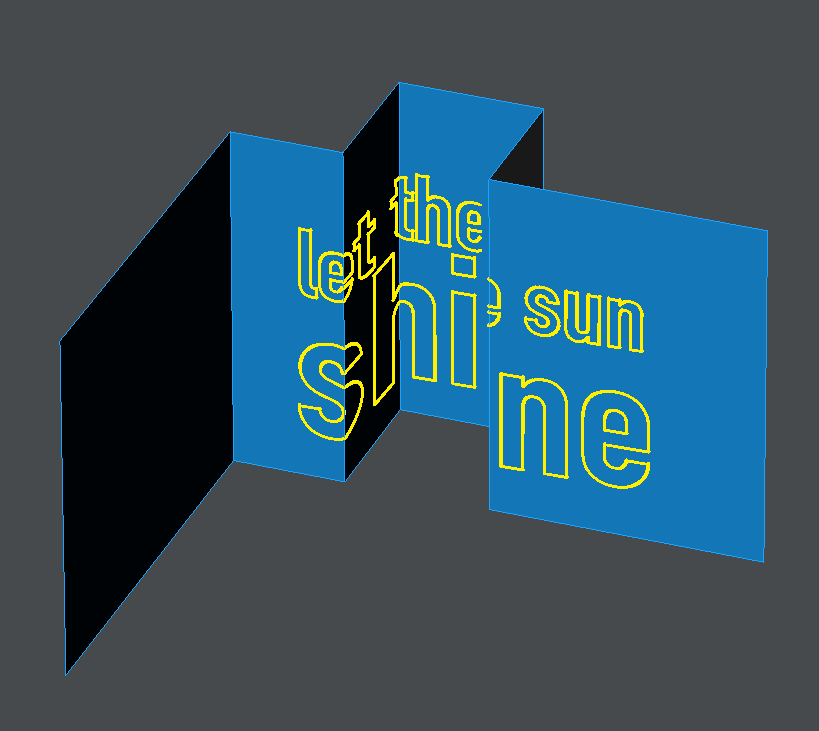

I’m working on a school project that I want to use vinyl to make a sticker which has a 3D illusion.
Something like the picture below:
Here is my way to make it:
  1. Setup the space and camera. The space is 20’ x 20’ x10’ H, and the camera is 5’ in height.
  2. Extrude the shape.
  3. Manually scale and move the surface in the back to match the shape in the front from the camera view.
  1. BooleanIntersection the wall and the extrusion and get the intersection surface.
  2. Delete the unwanted surfaces.
  3. Make2D to get the cutting file and export it to Illustrator.
I’m just a beginner of Rhino, so please tell me if there is any other way to make the sticker faster.
Also, since I want to make the pattern to be much more complicated, my laptop always crack when I’m extruding and scaling. I wonder is there any other command can bridge two shapes together. Loft doesn’t work at all…
Thank you so much and any help will be appreciated!

Nice work I think you have found a pretty good way of doing this. I don’t know if this will make it easier but to take the guess work out of the scaling you could:
In an ortho view turn on camera for your perspective view f6 key
Locate a point where the observer/station point is.
turn camera off
extrude your outline shape using extrude to point and snap to the point you just made
then scale in the opposite direction so you are past your architecture. For a bonus use intersect and you get your basic outline curve easily from the architecture and decal extrusion
For your more complex curves do your same method but instead of guessing the scale size snap to the above scaled back section. See attached file.
Also seems that grasshopper or a script could find the distance where the projected points on the architecture become coincident with the points from a perspective view. I do this stuff as well and it would be great to have a script or gh file that does this inverse scaling and intersection in one go.

I’ve been doing some of these for a few clients over time. @pascal very kindly wrote a quick script for me to sort it out:
ProjectPersp.rvb (4.8 KB)
Works like a dream. Remember… we have binocular vison so things like this work better from a photo with a single lens and messing around with the focal length. It’s the same with anamorphic imagery too - if you have a single view point where someone closes one eye it works really well.

project to cplane flattens whatever you have to this cplane you dont need that for your project, while project lets you choose which surface you want to project onto. first find a perspective you want and save it under named views this will also recreate the original cplane. then open the cplane window from your tools right click it until the entire list pops out as panel
and find the one with the eye its called set cplane to view which is not available as a command so you can only initialise it trough this panel which will help you creating a text according your current perspective. make a text object and arrange it as you need, pull it back and enter project into your command line, then choose any kind of surface polysurface.
but my method makes only a parallel projection which may not be enough for a 100% correct perspective because we dont see parallel. for this to work well you would need to look at it from quite a distance with a very long focal length lens. so the back parts would need to be enlarged. maybe rather see if you can get the projectPersp from pascal running which andy posted this seems the exact method which will go along your focal length setting from your rhino camera.

Hi @RichardZ, all - here’s a first cut at Pythoning this - see how that works so far.
ProjectPersp.py (2.7 KB)
Fixed a couple of typos, removed extra junk…
i tried on a 2 point perspective with 14mm and it seems to work flawless, a second cut could probably keep the point count similar low as the original, but other than that it seems to work perfect see short video. thanks pascal, something to play with.
