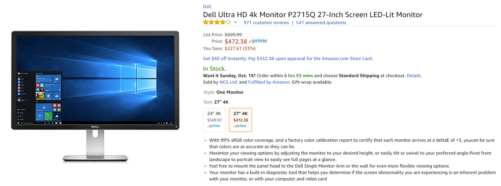

I just checked that Dell:
This is for total suckers. I have one of these 27" 4K ones I listed already, and they are amazing. If I wanted to see more content I’d get dual 4Ks at 2X the price, not 8K at 8X the price.
Sorry for being so boring.

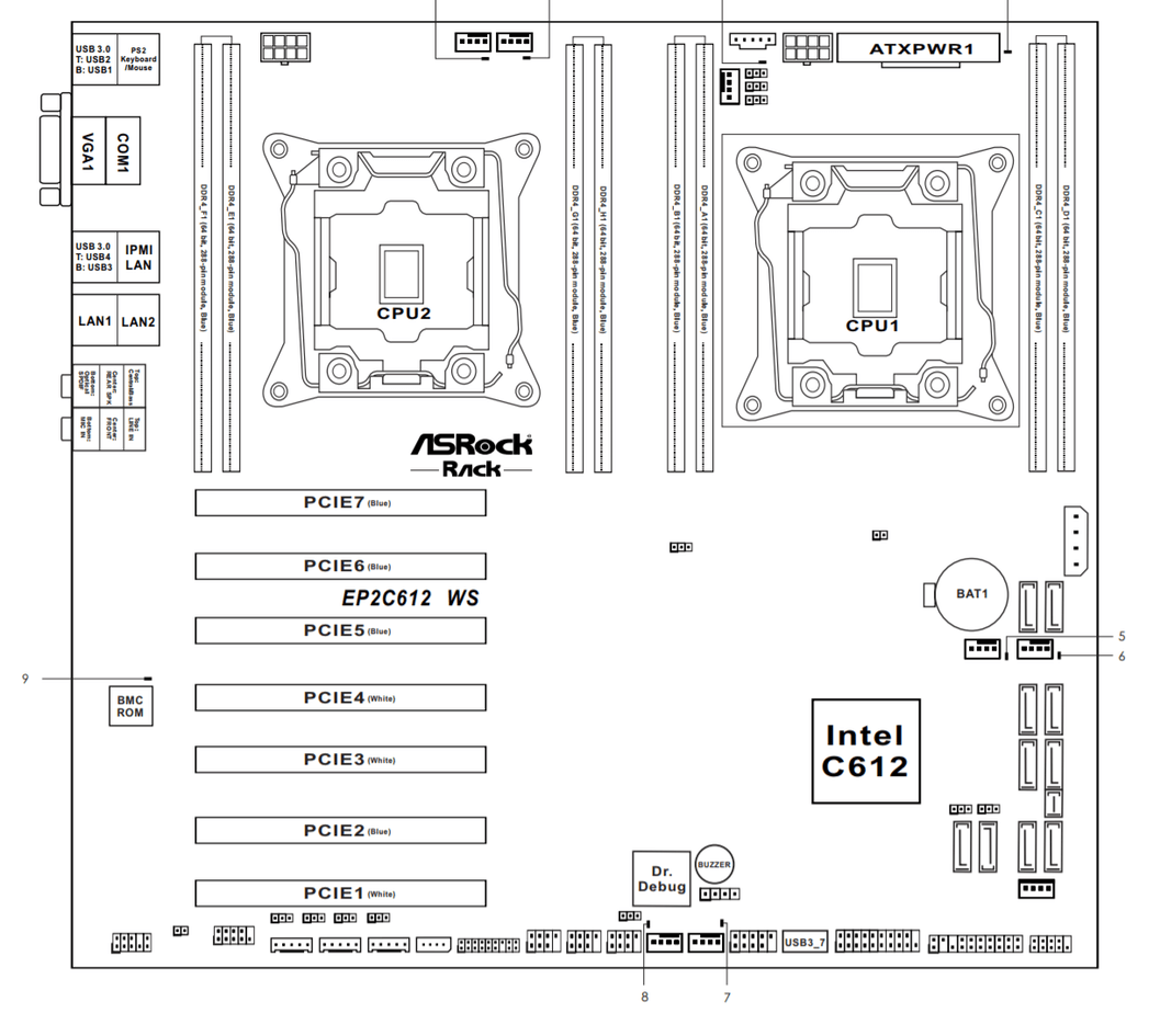

yeah those are great, excellent point, they make a lot of sense in a laptop, but for this desktop the mobo’s PCI slots will all be used (or physically blocked) by the 4GPUs’ space:
I’ll settle w/ Sata III SSDs instead. HHD speed shoudl be plenty fast, if I understand correctly, it is only important to launch apps, open/save files. But in constant use, if I have enough ram nothing is more instant than that. So my money is going instead to fast/plenty of RAM.

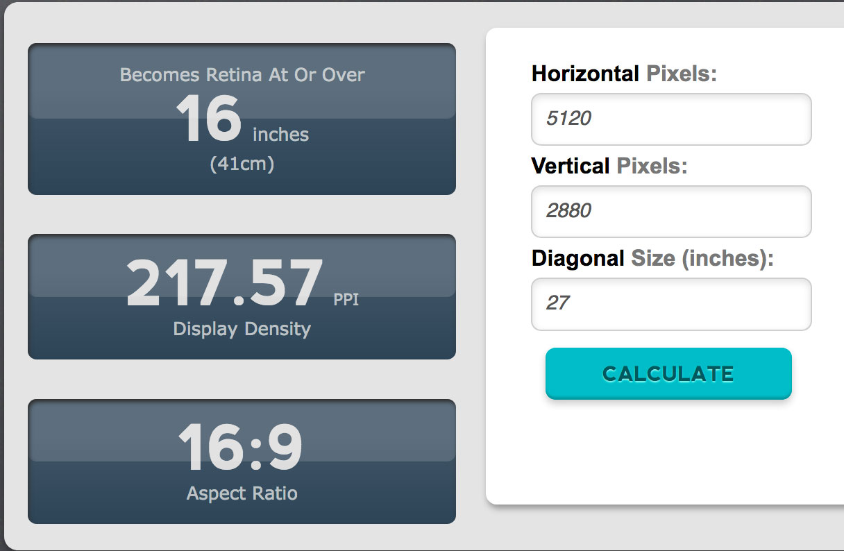

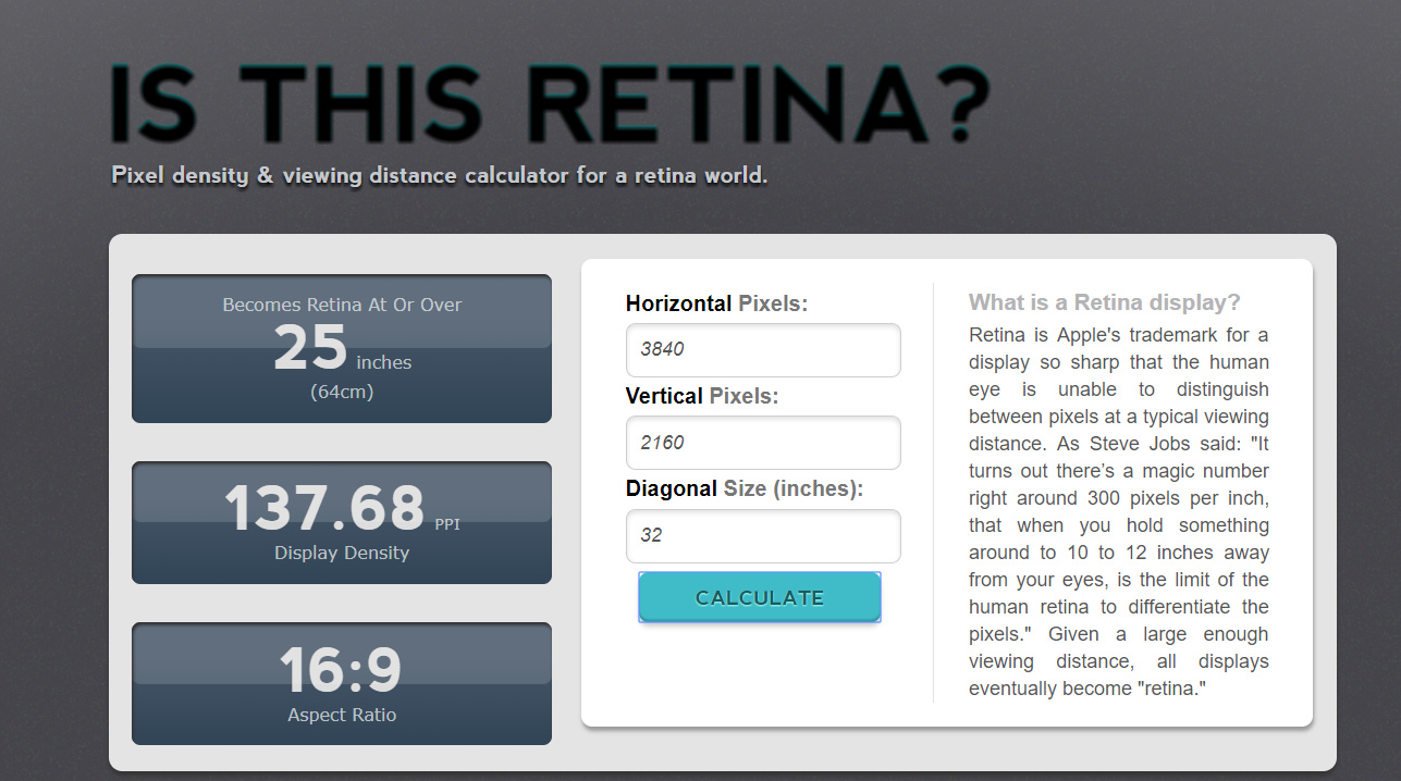

I’m using a Samsung U32D970Q since more than one year and would recommend you to look for a larger screen. 32" is a really good size, not to large.
Lovely that’s a biiiit too large for me:
I normally work on a standing desk at 23" from screen, and to take a close look I lean forward about 10" so “ll be looking at 13” away. I would be seeing giant pixelation! :rofl::rofl::rofl: … I know I’m very picky about this stuff.
Also I plan to add a second monitor to this setup later. so 27" is more manageable.
What else? keep finding holes in the plan, come on! There’s gotta be something we missed.
Relative IMO.
I have both a 32" BenQ at the exact 137.68ppi spec above, as well as a 27" 5k iMac.
Thought the BenQ was clutch when first arrived and loved it over ‘non-4k.’
Then came the 5k iMac. MUCH MUCH MUCH prefer to look at it now over the BenQ. I perceive a significant difference at any usable distance, but especially inside 25".
Now give me a future 32" 8K at $1000 or so, and you can have the BenQ…:wink:

One thing for the motherboard, not sure what would be an alternative, but the Z170 chipset may not be compatible with 8th gen intel chips. For future upgrade consideration.
Hi Toshiaki,
The processors and motherboard I chose seems compatible with each other:
http://www.asrockrack.com/general/productdetail.asp?Model=EP2C612%20WS#CPU
I’m not sure about what future upgrades you are referring to. Are you thinking that I will want to pull these processors out and place newer/faster ones in place, in same system?
Hi Gustojunk, yep I was thinking about just that.
Now that the 8th gen intels are starting to come out.
I see reviews that even though sockets are same they aren’t compatible… unless if it’s something the bios upgrade can handle…
Woops my bad, I didn’t see the below latest specs(I just saw the ASUS Z170-WS ATX LGA1151):
I see. I’m not worried about processor upgreadability. We we build systems like these they are usually useful for 5+ years, since CPU speeds evolve very slowly these days. So end of usable life of processor might equal end of usable life of the entire main system (mobo/CPUs/ram/GPUs/HHDs) and we might just keep the box and fans to replace with new guts.
I do anticipate to upgrade GPU’s. These are evolving fast every year and the used market is very fluid. It’s hard to sell used a Xeon CPU, but very easy to sell a used GPU, especially one sought after by gamers. So we can see pulling cards out, sell them, and put in faster model a year from now.
