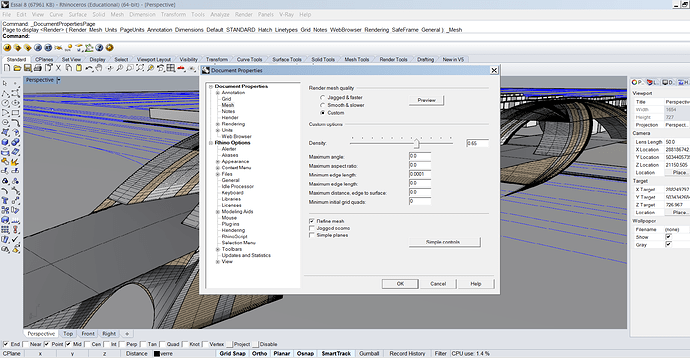

II made beautiful curved lines for my project, but when I want a rendering, they are all split up … Like on the enclosed document. I’m a beginner with rhino and V-ray so don’t laugh at me if it’s an easy issue :wink:

Then, I tried to change the render mesh properties but it doesn’t change much … (see enclosed screenview) do I have to change something else ?
I’ve made my project using “loft tool” so my surfaces are meshes or NURBS ? do I have to change ?

Your surfaces are NURBS but no matter what you do in Rhino things can only be “displayed” as a mesh.

How did you change the render mesh settings. From the image you posted it appears that you used “Custom” with zeros or all settings except Minimum edge length which is set to 0.0001. My understanding is the zeros result in the default settings so you may not have made a significant change to the mesh.
