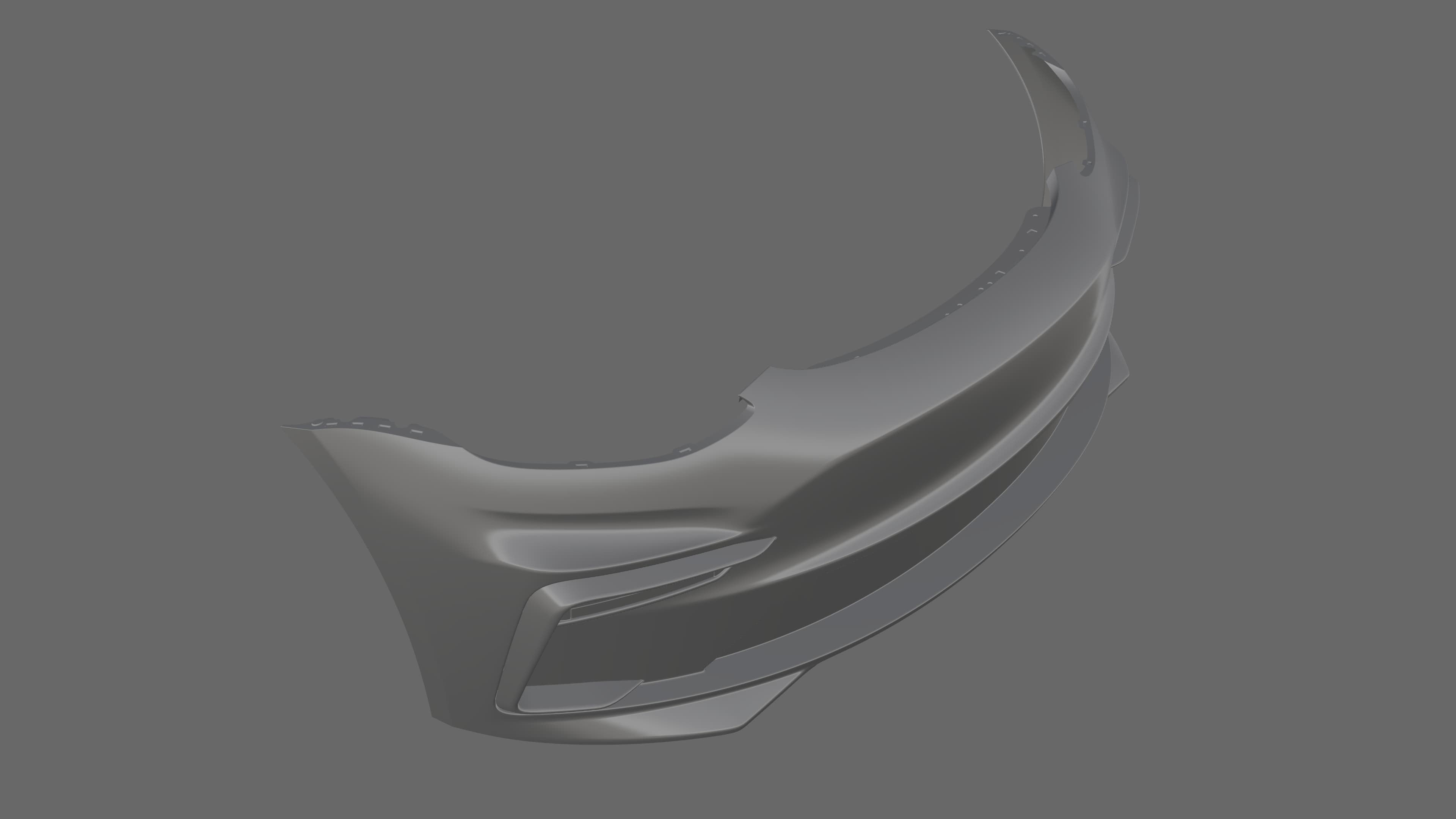

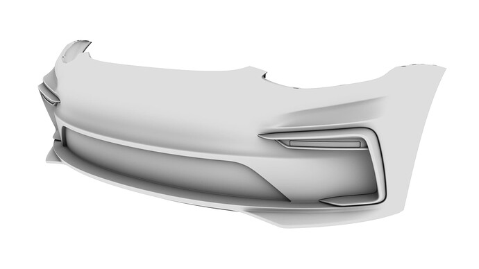

This is still a WIP project, so in the following days and weeks I will make a front splitter, an underbody streamline pane and will complete the engineering part of the DRL housing with mounting points and structural supports, which is currently only finished from outside. The front bumper is a tuning upgrade for the Tesla Model 3. I will post some additional pictures of the remaining parts when they are ready.
I used 3d scan data as a reference to create the NURBS surfaces within the required tolerances, and I was generally happy with the improved tools of Rhino 7 and especially the “Edge continuity” tool which is a must have while using “Match surface” and “MoveUVN”.
I would like to thank @Gijs for developing his great “Global edge continuity” tool that I also used in this project in a later stage of the work. It’s capable to handle multiple surfaces at once and selection of surface edges to analyze is much quicker compared to the standard “Edge continuity” tool. It reminds me of what the VSR plug-in offered for Rhino 5 years ago.

Looks great! Do you have any nice resources for going from point cloud to NURBS? Are you filtering the points in any way?
Thank you all for the nice words! :slight_smile:
With regards to the question above, there are two main ways to create NURBS geometry on 3d scan data in Rhino without plug-in such like Mesh2Surface:
  1. Use snap to draw curves with the ! _InterpCrv command directly on the point cloud, then use some of the surfacing tools to build the NURBS patches.
  2. Place a surface (with 4-6 control points in each direction) relatively oriented towards the normal of the mesh surface, then show its control points, select them all and run the ! _Pull command and select the scan data as the target. Rhino will pull the surface quite accurately on the 3d mesh, though there may be a slight deviation (after all, it’s the control points that are pulled, not the surface itself) and you may need to slightly adjust the control points along their normal direction with the “MoveUVN” tool to make the surface exactly align to the point cloud. Sadly, there is still no “Pull surface on mesh” tool in Rhino, but this little trick does the job in most cases.
Here is a simple video tutorial that I just made to show the 2nd approach, though I used “Offset surface” instead of “MoveUVN” to raise the pulled surface:

An alternative is to use Patch with Starting surface option to “pull” the surface to the mesh. This has the advantage that the surface, not the control points, is pulled to the mesh. If the mesh is very dense the user may need to first extract a set of points from the mesh with suitable density.
https://docs.mcneel.com/rhino/7/help/en-us/index.htm#commands/patch.htm
Another way to make a more accurate surface on 3d mesh is to rebuild the initial surface with at least 15-20 control points in each direction, then pull, then rebuild the resulting surface again to simplify it with 4-6 control points in each direction.

Thanks! Here are some more pictures, this time including the final version of the front splitter.
