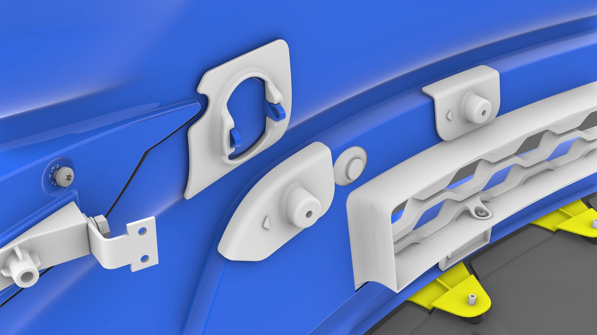

Just a short video showing the creation of one of the four 3d printed mounting points for the DRL housing.

Wow, I forgot to answer your question the other day. Just noticed that. :innocent: When I have to create an offset wall of the main model that I have, in most cases I prefer to use the “Loose” option to keep the control points at the bare minimum. Then, I manually build new blend surfaces since the “Loose” option makes them warped. You can see how I created such blend surface around the the offset surfaces in my video above at the 3:17 minute. I purposely made the blend surface smaller than the actual offset surface that it replaced, because the 3d printed part is intended to be glued to a carbon-fible housing, and usually that means that the small inner radius of the latter may have a slightly thicker wall in that particular area.

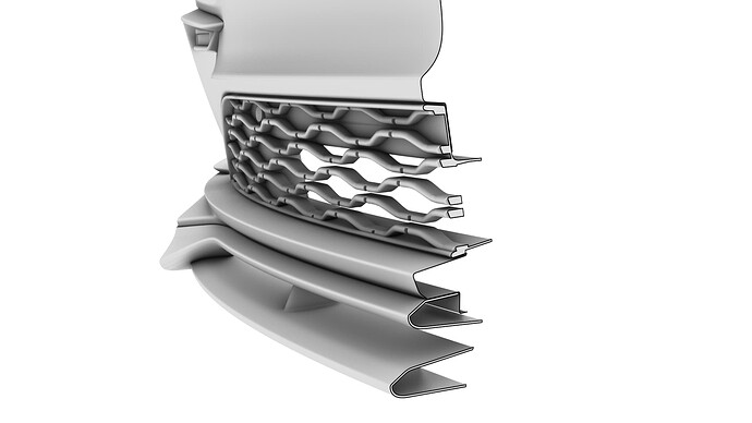

The front splitter is now split (no pun intended) into two pieces. Previously, it was designed to be a single piece. The underbody streamline panel is also ready now.

That grille flowing along surface definitely takes time, wow. :slight_smile: #multiplecrashes

Most Rhino users usually trim their primary surfaces with a curve, then build the secondary surfaces using the trimmed edge as an input. However, that leads to an unwanted excessive amount of control points that further leads to errors, inability to easily adjust the flow of the control points manually, and slightly larger file size.
A good solution to these issues is to build the secondary surface first, then trim the primary surface using the edge of the secondary surface as a trimming object. If necessary, commands such like ! _InsertKnot and ! _MatchSrf could be used to add a few extra control points to the secondary surface to further improve the continuity between the surfaced edges. That way, the resulting geometry has far less control points.
After lots of redesigns of the individual elements, the mesh grille is nearly finished and only lacks some mounting points at the back wall and a couple of holes for the parking sensors.
