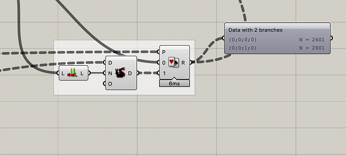

Sorry to bother you again @DanielPiker, I think I am double all my point by trying to use multiple curve.
Am I missing something?

Unfortunately still can’t get multiple regions to work?
Site_Adjusted_From_Contours_06.gh (80.0 KB)
Can anyone help. It looks like I missing something with my lists ?
