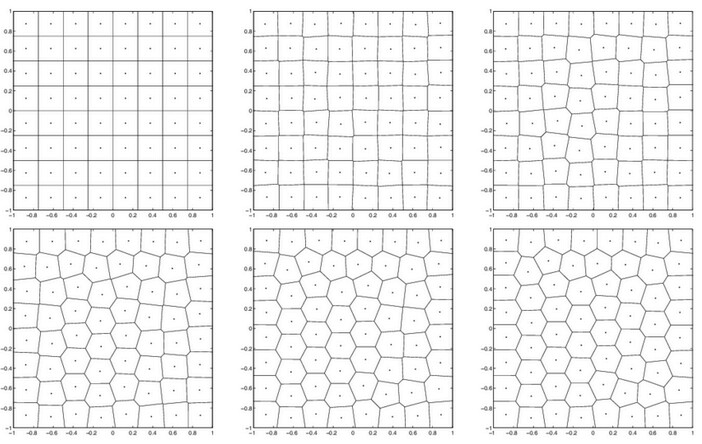

Both hexagonal and square grids can be generated with Voronoi if the vertices are evenly spaced, so what we want is a way to blend from one spacing to the other. This image kind of shows the change:
Source: https://www.researchgate.net/publication/239597123_Centroidal_Voronoi_Tessellations_Applications_and_Algorithms
I’ll have a quick go…

  • EDIT: Ah you say you want the polygon size to change. This might need Kangaroo to relax points between two grids.
Ok, that’s the easy bit
squares and hexagons.gh (12.5 KB)
Blending between them is a fun problem…
