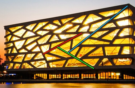

Does anyone have an idea as to how I can make a patter similar to the on in the picture?
I have tried everything from voroni and Delauny meshes to Substrate with Cull Pattern (which gave me the closest results) but they are no where near this pattern.I have tried using all the native grasshopper mesh tools but I am open to using plugins like weaverbird or parakeet if they will help me achieve a similar result.
Thanks in advance

The problem is I don’t exactly know how to approach making this pattern with voronoi as the geometry I need is supposed to be only irregular sharp-angled quads and triangles while in most instances voronoi patterns produce 5 or 6 sides of geometry and I don’t exatcly know how I can change the behaviour
I also tried using substrate which made close results on some breps what I concluded is that if I am able to divide a surface into several smaller surfaces and apply the same substrate method it might lead to a closer result

Henning Larsen Architects state: “The white facade of the cultural centre in Hangzhou, China, is punctuated with geometric windows designed to create a pattern like cracked ice on a frozen lake” (source: https://www.dezeen.com/2019/07/15/hangzhou-yuhang-opera-henning-larsen-china-architecture-news/ )
I think you can get the very same look of that facade using Gilbert tesselation as mentioned by Laurent, and I say so because I see multiple fracture lines that don’t start/end exactly on the boundary of the facade itself, but start/end onto other fracture lines
for instance, this blue line is for sure one of the very first splitting lines:
but in order for it to end like that in the middle of the facade, it means that another fracture-line had to exist in that location:
and for that green line to stop like that in the middle of the facade, it must have met another splitting line:
which must have met two… and so on until like this:
so, in order to justify the existence of that blue line, we created another 9 lines (number 4 is indeed listed two times)
my eye tells me that there would also be a division somewhere here on the right (in white), so this might be (and would, for this study) our first division layer:
now that we have determined the first layer, we do the same and divide each cell again (red color), and the number of division lines we grow for each cell might depend on its area:
and again:
you keep dividing each resulting cell independently until you get in a final situation where each resulting fragment has an area that lies inside the domain of choice: the keyword is “independently”, the division that takes place inside a cell is not related to what happens to its neighbors
