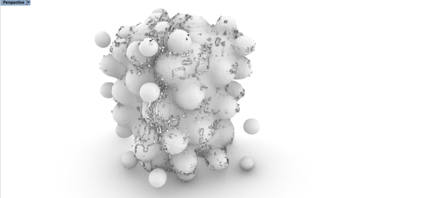

What’s the fastest and best method to pass from Metaballs isocurves to Meshes in 2020 with Rhino 6?
So going from this
to meshes.

I know a bit about Dendro and I was hoping there was something faster. I gave it a try and first result has this “voxel” texture:
And it’s already quite slow.
With some refinement the surface is way better but totally too slow (20s more or less)
Maybe the refinement could be done after the transformation from Volume to Mesh, maybe could be faster…

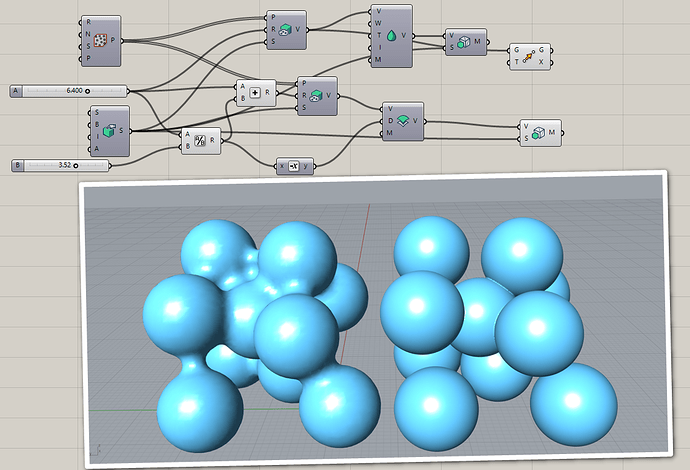

Rather than generating the section curves of metaballs, and then getting an isosurface of these curves with Dendro, you could generate the metaball isosurface directly from the points. This should be much faster.
dendroballs.gh (8.8 KB)

For sure Cocoon is the best choice, because it use fields and Isosurfacing.
Dendro has some use but it doesn’t simulate fields. You could simulate that a bit in Dendro using a bigger radius and some negative offset. But there are some bad places.
It is like a Connoly boundary
dendroballs_LD.gh (11.5 KB)

In the example you send me that volume offset was taking 42s :sweat_smile: don’t know the PC u have but for the sake of the project was too much… the solution of @DanielPiker with volume from points seems to be quite good for time saving.
Cool discussion the one u sent me about Connolly Boundary, during my research I didn’t find it. And cool solution u gave him! :wink:
Dendro is sensible to the size of Voxel, I put a lower value than Daniel. Negative Offset needs better surface quality so low voxel size. I am sure that for the same size of Voxel Cocoon will be longer than Dendro. But Cocoon will be better quality for Metaballs. It is difficult to have everything.

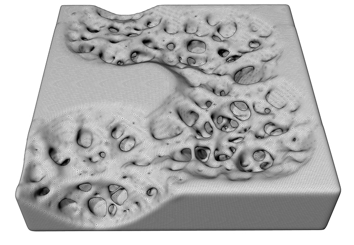

It would be nice if there was a tool for generating isosurfaces that would let users define custom scalar fields.
Dendro seems to be limited to linear falloff, so you get something just like a boolean union of spheres (and to get something smooth you need to do further smoothing operations), while Cocoon uses I think inverse square falloff, which gives you proper metaball shapes directly.
There are all sorts of other interesting scalar fields to explore though (see all the stuff people used to do with K3dSurf). I imagine something using an interface, where the user could define in a script any function that returns a scalar value for a point in space (using any combination of equations and geometry functions), and then plug that into the isosurfacer and get a contour at any value.
