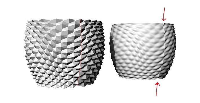

Im having a problem with the smoothness of a mesh.
I created a hexagonal grid to be map on a cylinder and generate some sort of skin.
I remove the duplicated segments that match on the edge of the cylinder so the mesh could be build and join propperly.
Anways, when I try to join the mesh and then smooth it Iā€™m not getting the result I want, which will be a single smooth surface on the cylinder. Instead I get the rounded corner where the edge of the cylinder is.
Why? :frowning:
After the join, but before the smooth, did you try Weld Vertices?
Join > Weld > Unify Normals > Smooth.
Thank you! that was it :slight_smile:
Thank you!! I was missing the Weld :grin:
