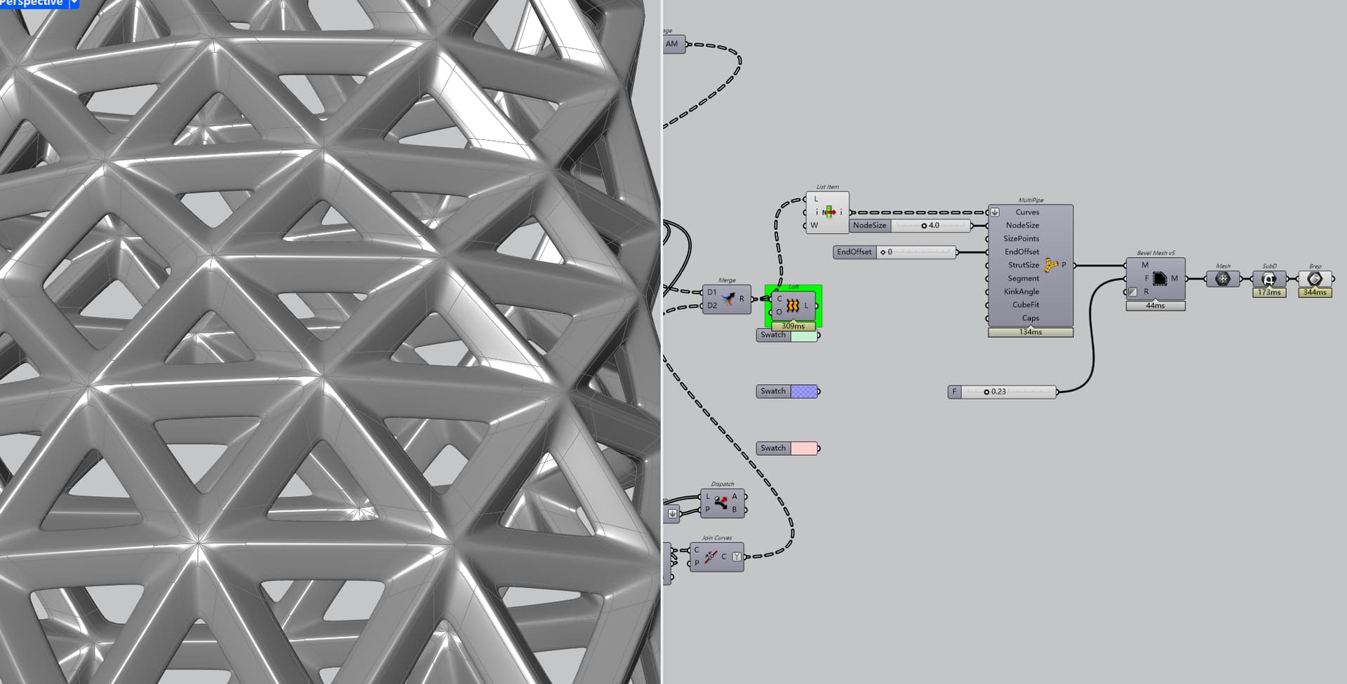

I want to merge two triangular Facs into one square-kinda shaped face, because the building i have to resemble (poly international plaza) doesnt have these green outloined structures, between the upper and lower triangular, in picture 1.
I have tried some things but nothing is working for me for now.
These are the two different triangular faces, in which I first want to cancel out the middle-line and then having the upper and lower triangular merged and at last have them joined together into one brep without the middle-line and finally having both merged triangular breps into one whole brep for the facade.

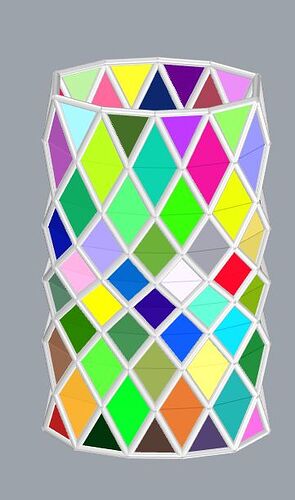

I got something but… (in the limited time I had available)
  1. Had to use Scale instead of Offset Curve (blue group slider), which is not ideal.
  2. Wasn’t able to eliminate the middle line that separates adjacent face pairs.
Other Notes:
Found and removed duplicate faces (yellow group). :frowning:
Deleted and replaced a lot of code :exclamation:
Used PopGeo to pick random pairs of adjacent triangles…
At the last minute, I colored the random pairs transparent blue.
poly1_2025Feb15a.gh (50.4 KB)

Instead of Scale I projected to a plane before Offset Curve (white group), then extruded the filleted curve to split the brep (two faces sometimes).
poly1_2025Feb15b.gh (50.7 KB)
