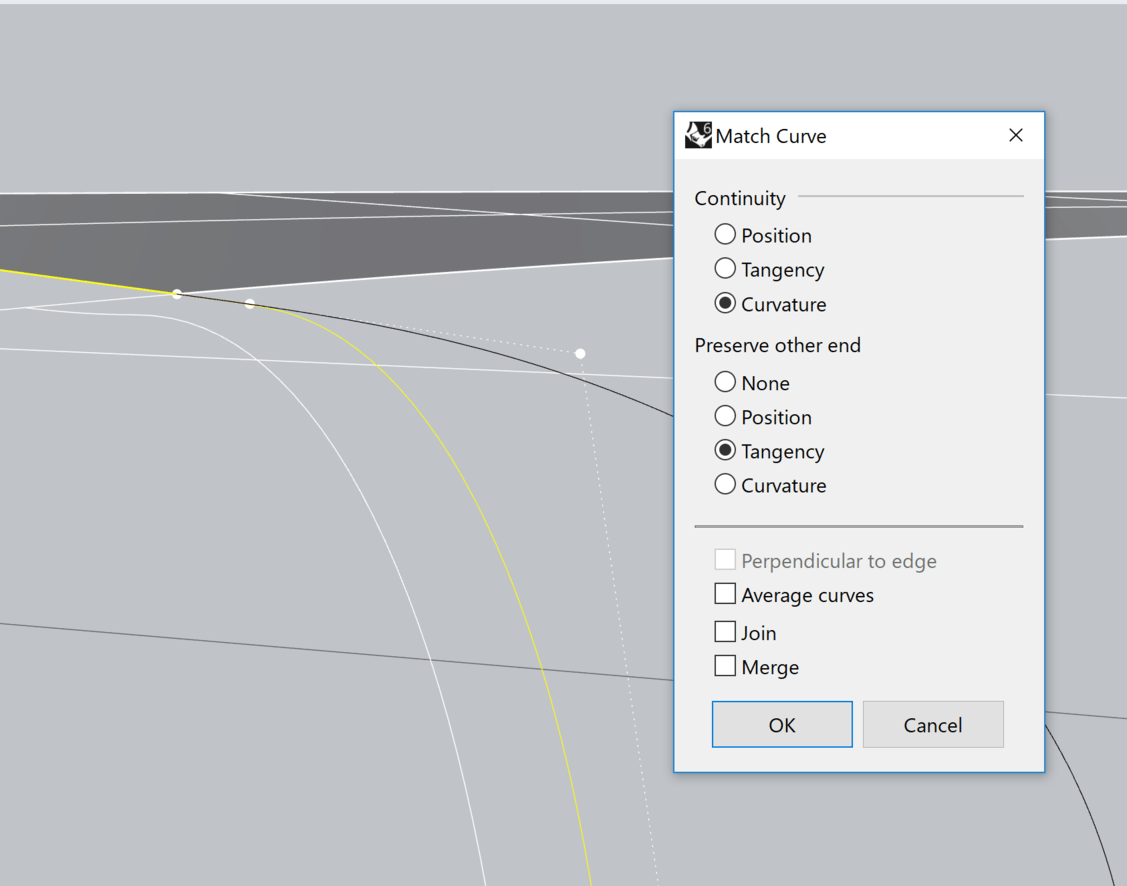

Looking for ways to make a match of curve with curvature, but
have a way to control the degree of that curvature.
Same for tangency.
Seems this is simple enough that It could be already implemented.
or is it?
Hello - by this do you mean controls/handles like in EndBulge or BlendCurve, or more continuity options (G3,G4 ) or?
Yes. By this request I’d like to have handles like in BlendCurve.
More continuity option maybe also good(I’m not at that level user yet)
I guess all tool should have the option so that it is consistent through out the program.
Also, it would be nice to get a “initial recommended” point from Rhino if that exists. (I guess what you get if you just run the command the first time, so if you want to go back to it you can.)
Hello - you can do this in two stages now by using EndBulge after the match - does that help, for now?
Yep for now it’s good. Thanks!

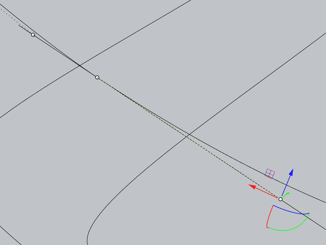

Related a bit, is there a way to align points so that they become on the same line as each other(so to put things back to tangency when the middle point is a kink?)
So below middle point is a kink, and while moving things aroung
the tangency is lost.
I was just drawing a line then snapping the point back to the line so put the tangency back, but seemed a bit clumsy…
(the line it self is a closed curve.)
Hello - I have an ancient Rhinoscript that I use for this, just checked and it seems to work -
AlignGrips_01_29_18.rvb (2.3 KB)
Drag and drop from where ever you save the rvb file and it will add two aliases
AlignGrips (User sets a line with two points)
AlignGripsCrv (User chooses a target curve)
In both cases the grips are alignd by closest points to the target.
_Pascal
