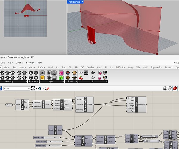

I was planning to do a box morph, but it seems like after i loft some curves it is considered a brep, not a surface and i saw on some threads that it wont work for breps.
Also, when i change the extent Y, it does not give me a proper grid inside the bounding box.
Thanks ok the second video is a fix for increasing the number of rows. So what I want to do is that i have the script that turns the curves into a lofted form, and i want that pattern to be applied on the lofted form.

I would start by creating a surface from the curves via Network Surface instead of Loft so that I get a surface instead of a BREP. Use the profile curves as U curves and curves created from the endpoints of the U curves as V curves.
Then I would Sporph the triangular grid (and only the triangular grid) from the surface that is its bounding rectangle to the network surface. You don’t want to sporph the entire construction because this will deform the panels. Once the triangular grid has been mapped, you could use Kangaroo to relax the grid… but that is a little advanced.
With the grid in place, I would then go about my construction of the panels. Give it a shot. I have a solution file that I can share with you once you have shown me your attempt.

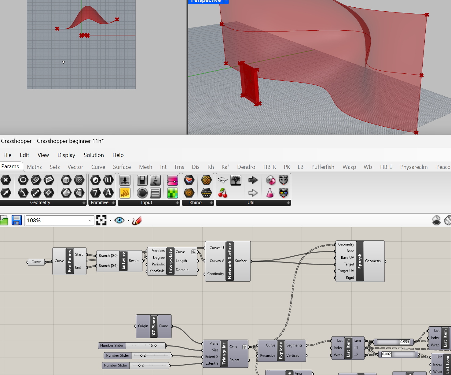

must I have V curves for network surface to work? coz i plugged in the existing curves that i have and the component is still orange.
ok thanks. Why are we using sporph here and not box morph? also, what do you mean by sporph from the surface that is its bounding rectangle? These are what I have tried so far:
Good question. We cannot use Box Morph because what Box Morph does it translate geometry from within a Box to a Twisted Box. You are dealing with a triangular grid and the extrusion of a triangular grid away from a surface would be a tiling of prismatic volumes… I suppose you try to do something slick and split your triangular grid into a rectangular tiling, but that is more trouble than it is worth. In the end, it is about using the right tool for the right job.
Here is sporphing the grid:
Map triangular grid onto brep VR 2.gh (30.0 KB)
and here is a video on the Sporph component
In your script nothing is happening because your base and target surface are the same.
Here is the rest of the script:
Map triangular grid onto brep VR 3.gh (32.2 KB)

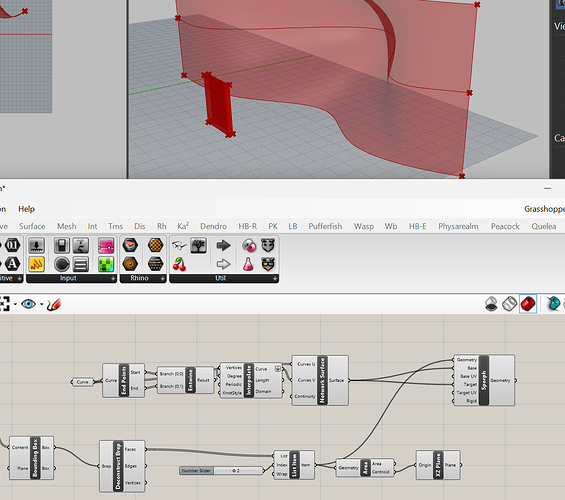

I did this here:
Map triangular grid onto brep VR 4.gh (46.3 KB)
although I’d be ashamed to admit how long this took me to figure out.
