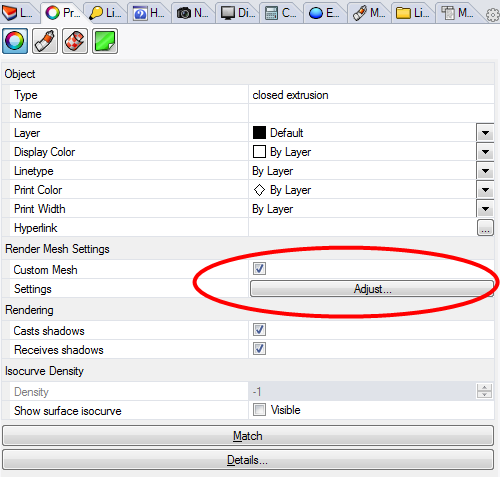

When making a scene that has many repeated shapes Rhino gets super bogged down. There are two examples that are both similar… surfaces with lots of holes in them. I have a student who is making a rendering of a supermarket. The backs of the shelves are basically like pegboard, so they have an array of holes that he Boolean’d out.
Another example is that I was making a rendering of a pool with lane lines. I made a single lane line disk and then repeated it. The disks have holes in them so they suppress waves in the water better. When I repeat the disks enough to make a lane line that is 25 meters long Rhino starts to really lag. (See the attached screen capture. Each disk is an inch wide, so the sections of lane line there are 13 inches long. This would be repeated about 75 times to make a 25 yard lane line.)
Are these just unreasonable things to try to do? Would it be better to make an array of holes rather than an array of cylinders that are boolean’d out? Are there other techniques we should use? Is there anything that can help other than more computing power?

You might need to consider if you need this much detail for renderings.
Each hole adds a lot of faces to the Rendermesh, regardless of it being a Block or not it needs to be rendered onscreen as a mesh.
So in you example of the perforated shelve backs, I would try and use an image texture to suggest the holes. Eeither by applying a texture with black/drak dorts or by using a dotted pattern as transparency map.
As for the lane disks; you could use texturing as well or remove the inner holes, as they are hardly visible anyway. There is no difference in creating an array of holes or booleans. However, in the example of the disk I would suggest to create separate geometry for the disk, rim and fins. I would not boolean them into one polysurface but rather group them (the fins could be a single fin for both sides crossing through the disk). If you would boolean them into one polysurface, it would add a lot of extra mesh faces to define the intersecting edges)
Last but not least I suggest to try and see how low of a custom mesh settings you can create for objects.
This is done at the object properties panel:
HTH
