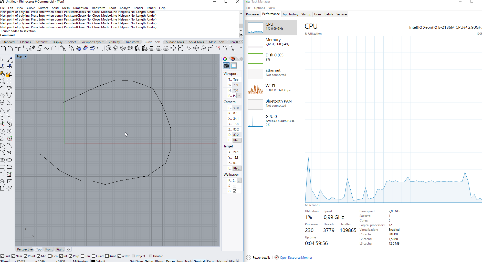

I’m having major performance issues on Rhino 6 Win 10.
If I draw any types of lines it takes like 1-2 seconds between each click. No matter the render mode or viewport. Basic solid shape tools seem to work little faster.
Any idea whats this about? I just got this laptop and I’m pretty sure I also managed to install the latest drivers. And my coworkers have similar issues with Rhino 6 + Win 10 also and my other laptop with Rhino 6 + Win 7 works just fine. I can’t work with this machine currently.

How is the performance when you start Rhino in safe mode?
Just to be sure, I would try disabling the lumion plugin in the pluginmanager and try restarting Rhino to see if the plugin could possibly be affecting performance.
Safe mode and disabling Lumion does nothing.
TestMaxSpeed shows FPS around 100 when ran.

Also, just to be sure, you are seeing this in a new empty scene from a factory-default template?
Yes, I’m seeing it on a new empty scene from a factory-default template showing ~100 FPS with _TestMaxSpeed and monitoring usage of my CPU showed some spiking, usage went from 5% to 20% when iniating drawing a polyline and clicking points on it.

Rasmus, just so that we are on the same page - 100 FPS is good, it’s about twice as fast as my PC can redraw the scene (without knowing your screen size, etc).
So, navigation in the scene is good but it’s when you need to draw something that the system slows down?

Yes exactly, navigation is very good but drawing any types of lines seems to make everything slow down immensly.
Here’s a screenshot of my performance from task manager:
Problem is fixed. Caused by a software called Avecto which gives admin access to users without admins rights and monitors yours softwares which would require it. For some reason this monitoring and requesting admin rights (?) made starting commands in Rhino super slow. Simple exception rule for Rhino 6 in Avecto fixed this issue.
I had the same problem as above and I’m using a somewhat high end workstation. I updated the Avecto software and it fixed the problem. Took me forever trying to troubleshoot the video card drivers, firmware, and settings only to have another program causing the issue. Must be something in the permissions granted in Windows 10 and this other software package.
