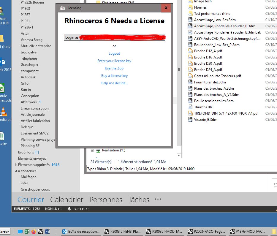

Hello every one. for time to time, my rhin 6 lost the license. and I’m not able to run a new rhino instance without close all rhino running.
if i close all rhino instance then I’m able to run rhino againe. do you have meet this problem ?

Hello recently, the bogu as hit again
you can see that i have a few rhinoceros instance on my Computer :S.
If I closed all rhino instance and i run rhino again. the rhino is open normaly

The next time this issue happens, please take a screenshot of the following folder before you try to fix anything:
%programdata%\McNeel\Rhinoceros\6.0\License Manager\Licenses

Running into this again and realize that the already open instance might not be responsive(enough) because it is running an intensive script.

I found in a single first test that GoogleDriveStream might be the cause. I see you have DriveStream running as well so it might be the cause at your end as well.
What I did when this happened again was to Quit GoogleDriveStream from the trayicon.
After quitting I could open Rhino without the licensing popup.
NOTE: I only quit DriveStream after all syncs were finished and after the test did a restart to get running again.
Maybe you can do this test to confirm DriveStream might be the culprit.
