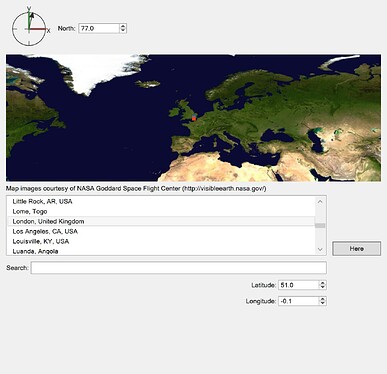

Oh and I believe the Here function is also working as intended. With my location set to Athens I click Here and it changes to London:
I click OK, save the file, close Rhino and reopen them and the location is now permanently London:

Here is a button that reads the position from the operating system and finds the nearest town. It’s helpful not to try to find the location in the drop-down menu. Alternatively, you can set manual lat and long. This is more precise but it does not make any huge difference even in a country size. (except huge countries like USA of course)
