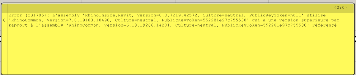

I’m trying this plugin this morning which seems very promising and it’s off to a bad start…
Why ?
Why ?
In revit with detail:
In gh (for rhino):
We see this issue appear sometimes when a user has some other plugins installed with Revit. Is this your case? It might be worth looking at the following link to see which plugins are conflicting with Rhino.Inside.Revit:
Please let me know if this yields some information we can use to further support you.
I used boostyourbim (AddinManager) to disable all plugin but I still have the same problem.
It’s ok for me !
I didn’t immediately understand that it was only valid for rhino wip
How do you produce this error message without installing Rhino WIP?
Have you ever installed and uninstalled Rhino WIP before?
The message should be this other one in that case.
I didn’t have rhino in the ribbon, it was when I started reviving that I got the error message
I see…
Many thanks!!
