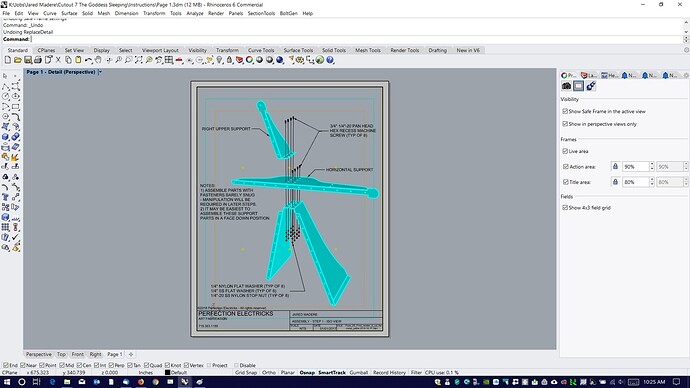

I apologize that I don’t even know the right terminology for this issue. I am creating an assembly instruction manual for a relatively simple artwork that has to be assembled by persons who speak another language. Therefore, I’m trying to make something akin to an Ikea or Lego manual, with the images in perspective.
I have created the steps in a single Rhino 6 model. Naturally, it’s huge, so I have copied and pasted each step into its own Rhino file. When I create the layout and insert the detail (and a title block), I can set the view to perspective but I cannot align or size the images in a consistent way. If I double-click the detail, I can see “Scale” on the Properties panel but when I select Edit, Rhino displays a message box that says, “Perspective details cannot be scaled”.
Am I missing something? Is there a way to do this?

I would like to arrange the details so that the lower corner is always in the same place on the paper and the scale is always the same.

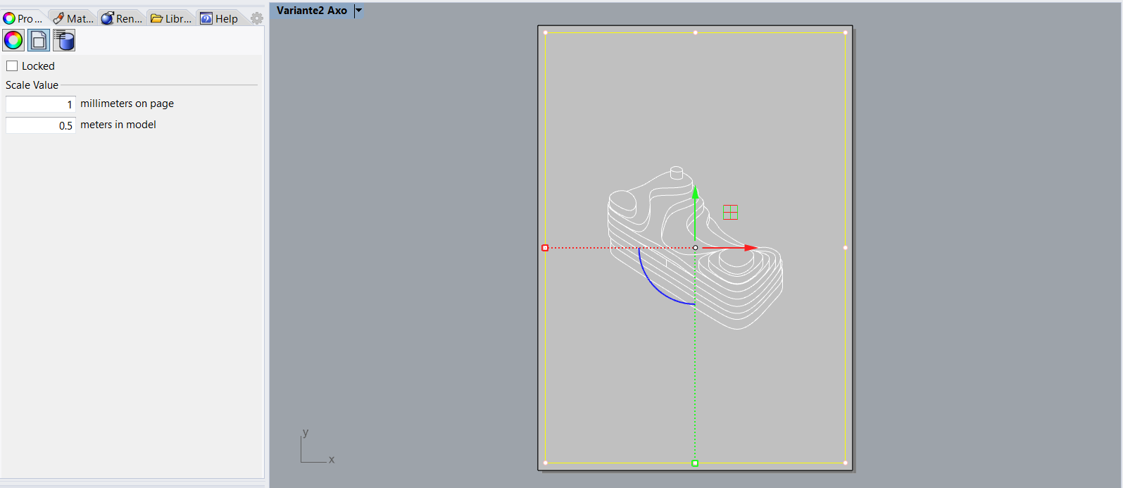

In manuals typically you would do a orthographic projection, which can be scaled accurately.
Is it important for you that your drawings are shown in perspective?
If not use the “isometric” option for your view and rhino will allow you to set a scale
THANK YOU! Never occurred to me that Rhino would treat perspective differently from isometric. Trying that, right now.
That worked. Thank you.
