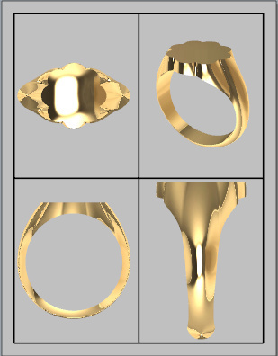

Here is a practical example. A jeweller wants to show 4 views of a ring to his customer. He clicks the New Layout : 4 Details button and get this:
The different scale of the right view will confuse his customer. The Rhino user should not have to go through extensive Layout tutorials to be able to produce a basic layout drawing for his customer.
As the image clearly shows, the initial display looks like the result of a Zoom Extents, which makes sense because Details views are generally set up at different scales for most Rhino users.
This signet ring example is a specific exception.
This is why I specifically suggested using a template file that is setup to do what you expect.
I think your change to the current behavior would be disruptive to far more Rhino users than it would help.

John, I created this image from the synchronized views of the ring. Rhino applied Zoom Extents automatically while creating the 4-view layout, and this is what I have a problem with. As a rule, the 4-view layouts should be at the same scale, unless determined otherwise by the user.
