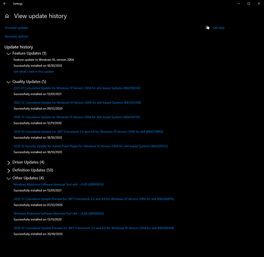

Hi Brian,
looks like no update failed
Below you can find SystemInfo and screenshot of Windows update history log

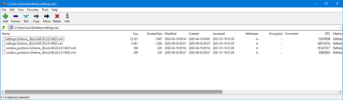

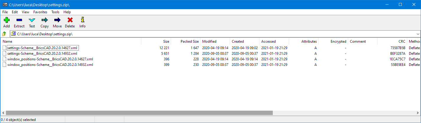

Ok, the next step is to try restoring your settings to their default state.
  • Close Rhino 7
  • In file explorer go to %appdata%\McNeel\Rhinoceros\7.0\settings. Rename those two xml files to have a different name. I would suggest changing the extension to .xml.orig
  • Start Rhino 7
If this doesn’t work, you can restore your customizations by closing Rhino and renaming those two files to their previous names
Hi @luca4,
Could you also try running the command “TestSystemScreenInfo”, and pasting the output here? This might give us a clue why it is not showing up. Also, after you click the buttons to bring up the color picker, do you have to press escape to continue working with Rhino, or is Rhino still responsive to other input/clicks?
It Does Works!!!
Apart from renaming the files I trashed four relics from BricsCAD trial
