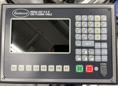

Our engineering department recently purchased an Eastwood Versa-Cut 4’ X 4’ CNC Plasma table. In the past, I’ve used Rhino to create the design needed and then export that file as a .step or .dxf to send it to the machine shop. Can I use the Karorocam plugin to Rhino with this plasma table to convert the files for the plasma table? If so, what post processors would suit this machine? Below are some examples of what shapes we would be cutting out.
Here is what the control panel looks like
Thanks!
Veronica H
Hi @veronica.hubbard
I did get your email this morning and I have spent the day working on adding support for your Eastwood Machine to KaroroCAM:
I need to do some testing this evening but I hope to upload a new version of KaroroCAM to the package manager tonight which should be able to get you started.
The one thing to note - KaroroCAM is metric/mm only - your machine will support this, but you may need to use Rhino’s conversion tools to change imperial models/drawings to mm units.
Thanks
David Kay
Thank You David and much appreciated! I was hoping I could use rhino for it all. Sorry, I posted here too, I wanted to add the picture of the control panel, wasn’t sure if you needed that or not.

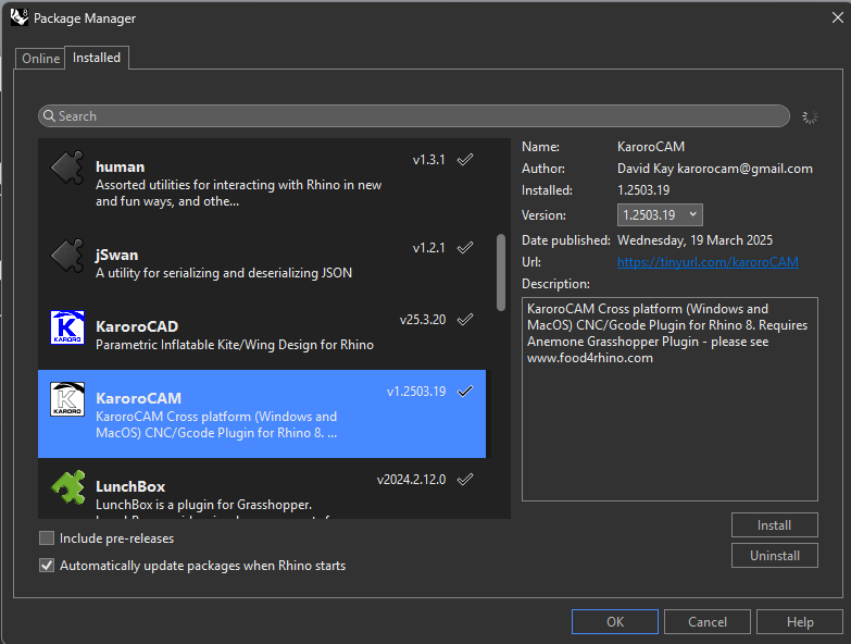

Thanks for the update - and fully understand how things get busy.
If you have “Automatically update package when Rhino starts” checked in the package manager dialogue you should get the update as soon as you open Rhino:
Otherwise its just a matter of opening the package manager and going to the installed menu and pressing the install button on KaroroCAM.
I recommend you do this and re-export your G-code before you test cut.

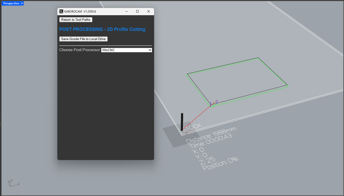

Hello, I am interested in a MacOS CAM alternative. Truth is I only have a Windows machine because it is required for CAM. I would prefer to not have a windows machine.
Is there any summary of features and machining strategies your program offers? I am curious how comparable it would be to RhinoCAM in terms of machining strategies, ability to produce detailed simulations, etc. I have been machining fairly complicated one and two part molds, and I have found that simulating the tool paths in high detail is both important and a huge bottleneck with RhinoCAM.
Also how do you deal with post processing? I have a WinCNC machine, which uses pretty basic gcode.

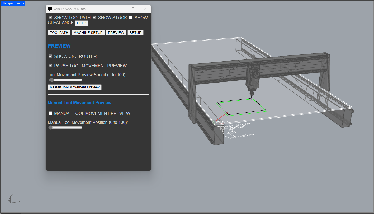

Hi Darren,
Great to hear from you, and thank you for your interest in KaroroCAM.
For a full list of the available toolpaths in KaroroCAM, I suggest downloading and installing the software from the package manager:
All available toolpaths are included in this file, and the software is fully demoable without a license. A license is only required to export the final G-code to your local drive.
You can also check out the KaroroCAM YouTube channel—there are videos demonstrating how to program most of the available toolpaths, along with a current project where I’m using KaroroCAM to shape a surfboard:
I added a POST for WinCNC this afternoon and uploaded version V1.2506.10 to the package manager. It’s based on sample export code from F360. However, if you send me a sample or two of your own .tap files, I can refine the POST to better match your machine.
Regarding simulations: tool and machine movement previews are currently available, but stock removal is not yet implemented. It’s on the development list—a prototype exists, but it still needs refinement.
Custom stock support for 3D roughing toolpaths is the top priority on the dev list. I’ll post an update here as soon as it’s ready.
