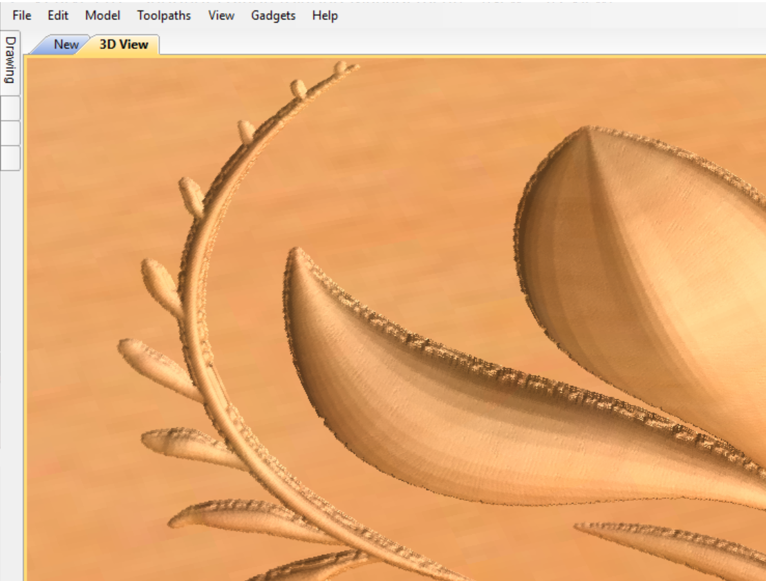

I designed this in Rhino and then imported the .3dm into V-Carve and this is how the edges come out. This is just one of many examples of how curved edges get lost in translation for me. This is the rendered view in V-Carve. It also shows the toolpaths all jagged near the edges. I’ve posted on the vectric forums, and have tried numerous fixes, like adjusting the resolution, adding a z-zero plane, to no avail.
I see. Can’t help you with RhinoCAM or madCAM, as I haven’t used either, but I’m interested in other peoples experiences.
For this specific example, could it be helpful to use a v-bit on 2d curves for the v-carve /engraving toolpath? Or is a round bottom necessary?
The problem is, though, even trying to use a v-bit on 2d curves, the curves are still jagged on the 3d model, so the only way to get smooth curves is importing it into V-Carve as a vector. That kind of defeats the purpose, and hinders productivity, it seems like.

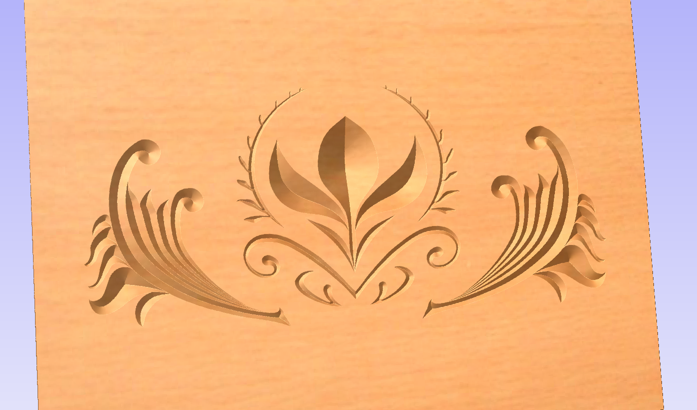

You might be on to something there, though. This design I think will look really nice if I cut it out with a v-bit…
I’m going to play with it and see…

Just for the heck of it, try exporting an STL (if you have not already tried that) instead of the 3dm. Its possible Vectric is only using the display mesh, or is poorly meshing/rasterizing the nurbs surfaces.

I’ve tried exporting the Rhino 3d model as a mesh with the smallest angles/super high rez as possible…Still have the jagged edges.

For this particular part, I think siemen’s suggestion of using a v-bit to cut out the design might work. I’m going to redraw the vector curves and try that for now. That would definitely cut down the machining time 10-fold, for sure, as opposed to 3D carving…Screenshots to follow…

Yeah, also what I wanted to point out. It’s way faster then 3d milling and perhaps you can combine it with some fluting toolpaths. Curious of the results.
This was created with V-Carve and a pointed bit, using only vector paths set on the surface of the board. All of the depth of cut data etc was generated automatically. It was fascinating to watch it being cut and needed so little cleaning up afterwards it had to be seen to be believed…

Hi Matt, I’m trying to figure out how the crisp, square corners and edges were created …
the bit is V shaped and it can move up/down while also traveling in the 2D directions… so it can make pointed corners when working 3 axis.
Thanks Jeff, I get it now, the bit runs up the edge at the angle of the vee cutter.
I redrew the design in V-Carve with with cleaner bezier curves from the imported Rhino 3d model used as a guide.
I then used a v-bit toolpath to generate this:
I haven’t cut it out yet, but I kinda like the overall look using the v-bit as opposed to a 3d toolpath using a ball end mill.
