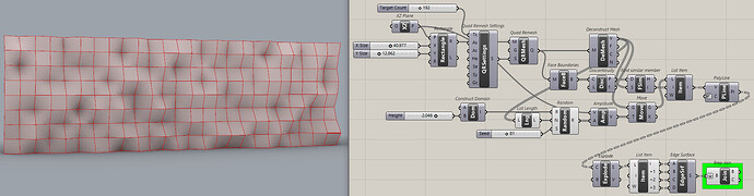

Hello. I’m trying to create a jagged, varied surface in Grasshopper. I’ve followed many tutorials that create different surfaces, but they all end up with smooth, curvy, radiused profiles. I need to be able to create a jagged, rocky-looking surface that is variable. I have an example below, but need to be able to do it parametrically, perhaps using the “populate” modules. Thank you.

you can have this effect by using a mesh and then unwelding it. Here I used my plugin for the noise but it could be also use of random or other noise type.
Plugin Nautilus, NGon just for the naked vertex status
And if you don’t want the triangles (mesh are transformed to triangles), explode the mesh and subdivide the quadrangles. They also could be transformed to surface if needed, via Subd for example.

Flat (planar) triangles!
jagged_srf_2024Feb2c.gh (14.3 KB)
Using the ‘D’ (Dual) output of TriRemesh. The hexagons are not planar but Patch handles that.
jagged_srf_2024Feb3a.gh (17.6 KB)
P.S. Hexagons from Patch don’t work well when you try to join them into a single polysurface. But QRMesh (Quad Remesh) and EdgeSrf work fine.
jagged_srf_2024Feb3c.gh (19.3 KB)
Like the first version yesterday, surface fragments are not planar (flat) . Triangles are needed for that.
jagged_srf_2024Feb2a.gh (13.3 KB)
