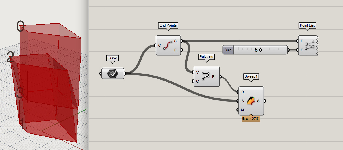

Try this: ( right-click => Set Multiple Curves on the curve param to reference your sections )
The order of the curves in the list (order of selection when you reference them) matters, which can be tracked visually using the Point List component:
If your sections are all increasing in height, you could instead sort them automatically by Z coordinate and select them any way you like:
