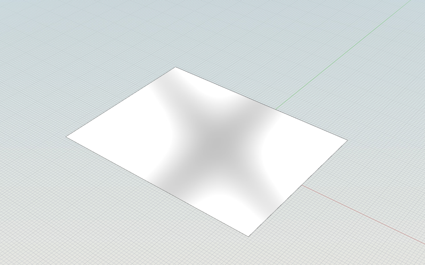

I just installed the latest version of Rhino 9 Beta ((9.0.26188.13293, 2026-07-07)
Commercial), totally factory reset with zero customization and only consisting the default Rhino display modes. It took whole 58 minutes to install.
Here is what I get when I switch from “Wireframe” to “Concept” display mode on a basic rectangular surface:
This environment map is either part of some material in Rhino or included in a library with environment maps. I have no idea, but it’s part of Rhino’s installation files somewhere.
the screenshot shows otherwise. Your command line is gray and you loaded other display modes than the factory defaults.
But that plane is weird. The environment should not be visible on a plane without material. If it has metal you’ll see some of it though:
I deleted the two custom display modes before taking the screenshot. I even reset the program again and still get the same issue.
As for the gray background, perhaps the reset Rhino 9 Beta reads some leftover settings from some folder.
The plane was built via the ! _Plane command, it’s not imported from a 3dm file.
