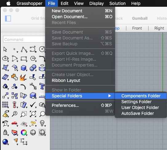

You need to grab the no-admin macOS version of weaverbird here.
After the download has finished, you need to extract the zip-file to a temporary location on your computer (i.e. Desktop). Open Rhino Mac and Grasshopper.
In Grasshopper, open the “Components Folder” under File > Special Folder > Components Folder and copy or drag-and-drop all the files from the zip-file, except “weaverbird.rhp” to that folder.
Restart Rhino and you’re done!

Thank you for your kind guide !!!
47%20AM
