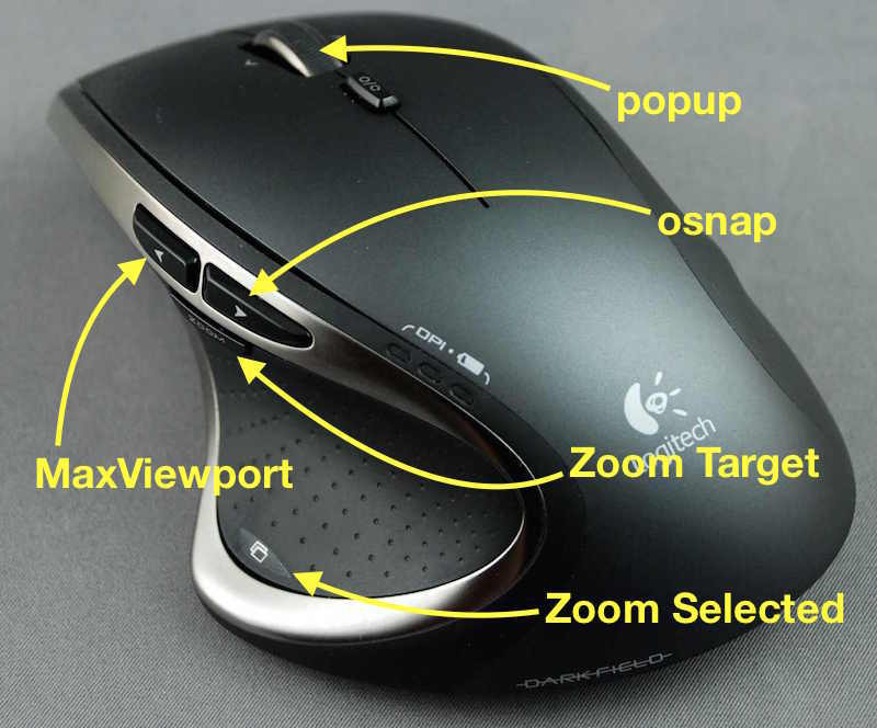

i have it on a thumb button and use it often… you can zoom in real far/quick/precise plus the camera will orbit around the point you click.

all sound very useful, especially _ZoomTarget
what is a thumb button, something on the mouse ? if so, how did you do that.

Mice can have more than two buttons these days (some have dozens). The “thumb button”, as then name implies, is a button under your thumb (or to be operated by your thumb). Some mice also have several thumb-operated buttons.
Is that a serious mouse ?
no way can ones thumb make use of that set,
I prefer smooth thumb rest, far more comfortable. and buttons where I can get to them with a slight difference of postion, not under a human digit waiting to be accidentally triggered.

i’m on mac so the how part probably won’t translate well… i assume you can assign commands/macros to mice buttons in windows rhino though.
fwiw, i use a logitech mx performance mouse:

yeah @KevJin… mmb works fine/reliably…
I dont install logitech software and just drive it via OSX and do the customizing through rhino.

What is the overall length of that mouse in mm ?
I ask as lot of mice are too long and their rear end is up against my gel wrist rest before I even attempt to move it backwards to bring cursor down screen. 115mm is the length limit for me. The bigger mice are not of use, if wrist rests on gel pad.
I dont want buttons directly under thumb that I am frightened of activation, grip is light on mouse but button click needs to be not easily triggered and also not an effort, else precise control gets lost upon click.
Is that shelf like rubber pad a button or just the tip active where the screen-printed white emblem is ?

i use that mouse with my laptop… the middle mouse button is actually the little button behind the scroll wheel instead of the scroll wheel click (pushing the scroll wheel toggles between click-scrolling and smooth-scrolling)
to configure it:
Rhinoceros-> Preferences-> Mouse-> Mouse
• Middle Mouse Button
(i have that set to ‘popup menu’)
about 5 1/8" …~130mm
the whole thing is a button but you have to explicitly press downward (or roll your thumb down) to trigger it… you can squeeze inward as hard as you like without triggering… whoever designed the thing thought it through pretty good.
