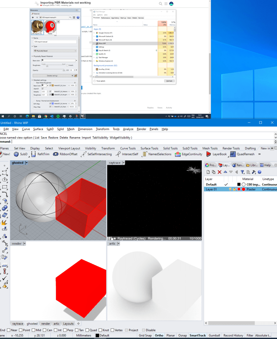

When I try to import PBR Materials, Rhino hangs and I need to shut down. I have done it a few days ago (once), but I cannot do it since the last update (yesterday?).
Thanks, N

Hi Pascal,
I tried again and repeatedly “import from material library” and “create physically based material from texture files”.
I also tried “Create new material” >> “physically based” >> detailed settings and when I selected the textures it freezes.
I never got to a dialog box beyond indicate which zip file to use.
I also found the very first PBR material that I tried (and worked) before the last update, but also did not work. Unfortunately, I did not save the rhino file of that test.
Any other ideas?
N

Further to the previous post, I tried to insert the texture manually one by one.
That worked but there’s something not really working with the rendering.
See below.
N

Hi Andy,
I found the problem. I unplugged my second screen, which made everything collapse on to the main screen and the dialog box appeared. So the dialog box was there somewhere all along but out of bounds of both screens. When escape is pressed it does not go away and perhaps I haven’t press enter (??).
When I re-plug my second screen, it is out of bounds again, but now I managed to see a little corner peeping on the top left screen corner and was able to bring it to the screen.
Almost happy with that, I imported a second material but again the dialog went out of bounds, this time totally (no peeping corner). Unplug screen and there it is again, re-plug and it is still there.
After a couple more tries, I realized when rhino is in one screen it works when rhino is in the other screen it doesn’t.
N

Hi @nsgma,
I’m looking into this and found something that could perhaps cause this issue, but I’d like to verify given your exact scenario. Could you go to the windows Settings app, and navigate to System > Display, and tell me what scale/DPI you have for each display? e.g. 300% for second screen, 100% for primary screen, etc.
Also, could you take a screenshot of the layout of your displays, for example the following:
Finally, could you identify which screen you are using Rhino on?

Thanks to @curtisw great investigations and instructions I have made a fix for this and committed it. Hopefully it works. I will keep the item in “needs testing” state.
The fix should be in the next WIP. @nsgma It would be great if you can confirm that it works when you get the next WIP.

Hello @maxsoder,
After the last update, the problem persists.
@curtisw,
here is the display layout. The problem happens when Rhino is on screen 1.
N
@nsgma Thanks for testing. Did you try this with the lastest Beta release?
The dialog stores the size and the location of the dialog when it is closed. Have you tried to open the dialog and close it only using one display. Then it should store a location that is correct. Then one could try to test with 2 displays and see if the problem still occurs.
