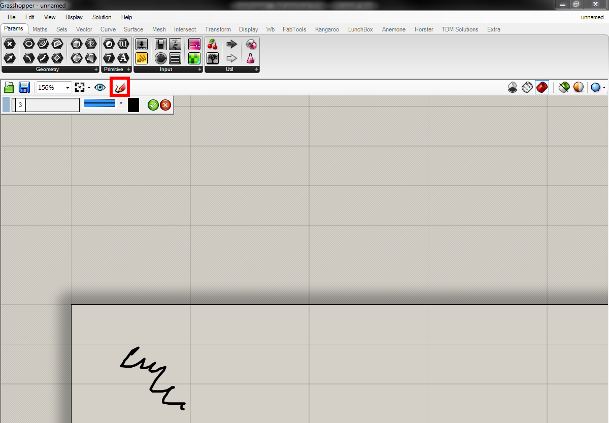

The coloured blocks are just normal groups (select any grasshopper components and press CTRL+G)
However what’s in the group is a bit of a trick.
It’s a transparent Sketch object drawn to exactly the same size as the canvas grid minus the extra width that the group adds. It’s part of our company template we use to help make all our definitions consistent.
The bunny is internalised from a file I had lying around (made from the Stanford bunny using mesh machine if you are interested)
