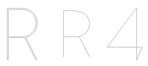

Image of two text items in the toolpathing software:
  • Left is imported ISOCP font from Rhino
  • Middle is updated ISOCP.shx from in toolpathing software
  • Right is a MecSoft numeral 4 (as an example of its weirdness)

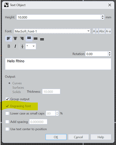

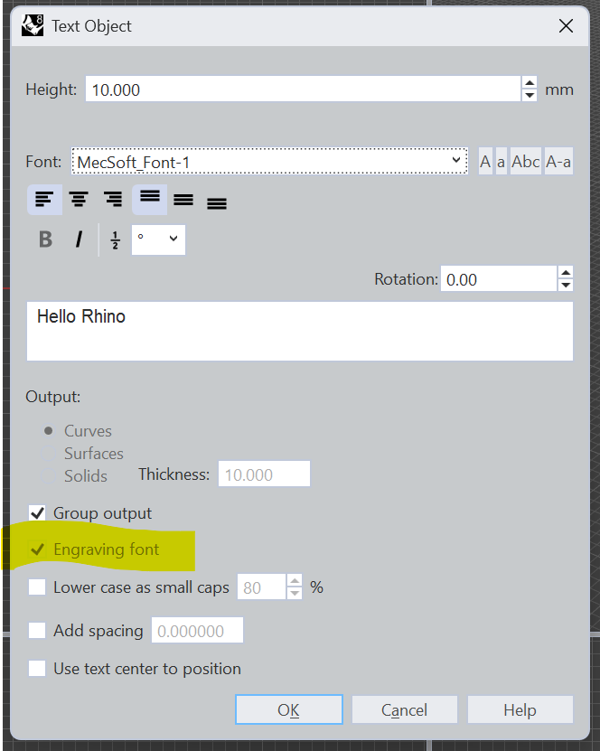

Normally single line fonts should automatically check the “Engraving font” setting in the TextObject command.

These are just very basic scribe marks for identifying parts, so I’m not sure textobject is what I’m after. We use Textobject for our embossed work. I will look into it though.

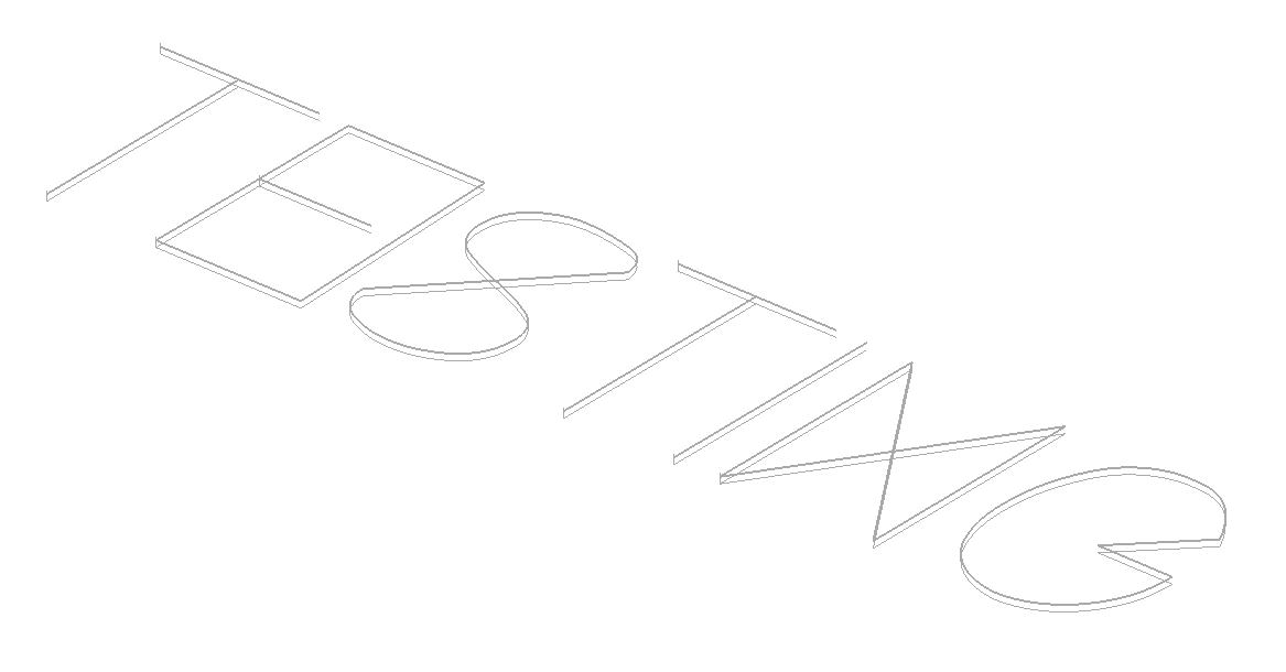

I’ve tried SLF-RHN Architect also, but it works better exploded too. Image below of this font toolpathed as text.

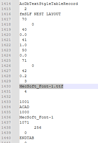

I am exporting a dxf. Perhaps there’s a simple way by just substituting *.ttf with *.shx on dxf lines such as this.
Bingo! It works manually. How about a tick box on the export options, “Export fonts as shx?” All it does is find and replace ttf to shx. Leave the font name unchanged, user needs to ensure the ttf and shx font names match.

All toolpaths are closed. Are you rebuilding polylines?
Exporting curves works, no arguments. But it is a workaround.
I’m want to toolpath text to try to avoid intermediate steps to use polylines (explode or textobject) or change the font at toolpathing. Creating and maintaining the nests with these intermediate steps is a pain.
That’s how the toolpathing software interprets ttf fonts. Yes, it is closing the font unnecessarily.
