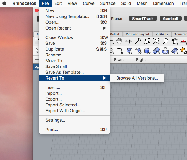

I lost some of my object in Rhino space; how do I bring them back?
After hours spent with Rhino 5.2.4 sculpting objects, unknowingly I touched something sending some of my objects into Rhino space.

if you didnt hide it accidentally (use Show to unhide) and its just some where moved out of sight you can just hide the visible objects away and use CMD A to catch whatever is out there and use Align Concentric for example and define one point where it will be set back to. in case its shrunk down immensely you can then use Zoom and click on Extents the camera will relocate to the existing object and fit it to screen.

…I have objects which are in the same layer but places far from eachother …well atleast they are after my mishap!! I am therefore not sure of how to “pull” the objects which are outside the plane back into 0,0.
Thank you for the comments …Im afraid they still isnt clear to me how I solve the problem :frowning:
If you spent hours, you can also just go back in time, so to speak with File / revert to / Browse all Versions
Also Zoom Extents (active viewport) or + All will bring objects into focus in all viewports.
Randy; THANK YOU :smiley:
As you can see with your help I’ve managed to get my objects “back from outer space” …Im very grateful!
So easy …and I had no idea this function existed!
Sanne
To create “snapshot points” do a command + s, even if your file is saved. This creates a time so Apple can go back to this. I usually do this after I make an important change or sometimes before I want to delete something.
The beauty of this is you can actually go back in time and get an object or objects you deleted, copy it and then move forward and paste the object back into your document. Sometimes this is even capable when a file is closed and then reopened.
This is an Apple feature that Rhino has incorporated. Not all software uses this, it is based on Time Machine .
