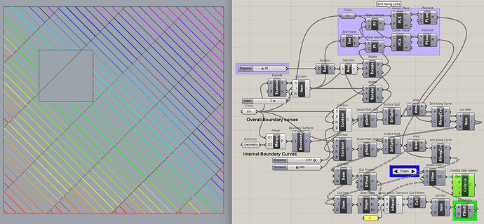

This is an example of good intentions gone wrong. In my usual fashion, I saw things in your code that I would do differently and started hacking. I forgot that SrfSplit results need to be sorted, which added unforeseen complexity and is still flawed. :frowning:
Problem with Shatter_2025Oct1a.gh (48.8 KB)
The Value List (blue group) switches between edges and surfaces.
The two groups of curves in you scene do not full establish intersection points. so I used Null Item to identify the Null data from Curve|Curve , and then used Dispatch to extract them, which are the "missing " curve you mentioned earlier.
