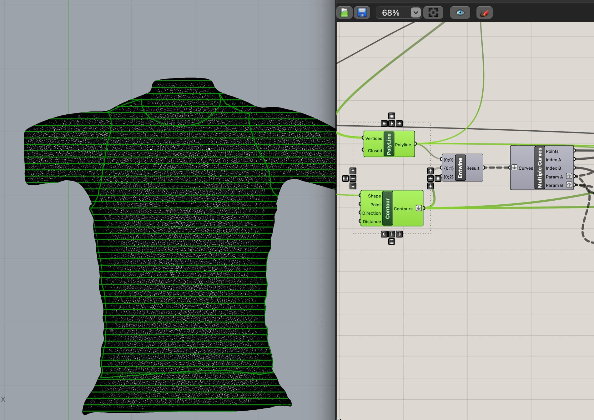

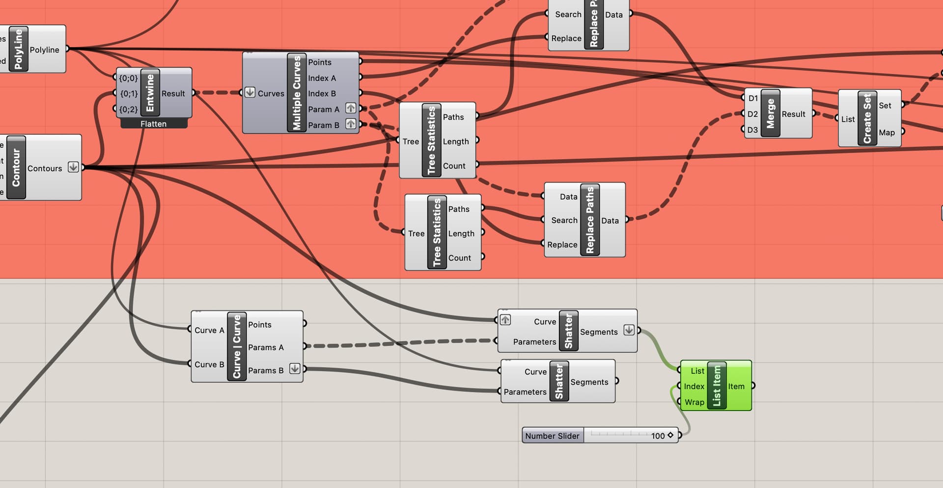

@inno - I found your solution and thought it should be working for my problem as well - as it is basically the same. Since Rhino 8 does not support NGon anymore I had to change my code to shatter curves at their intersection points with regular GH components. I tried a few things and even experimented with a python component until I tried your solution. It seemed to work just fine, but in the last step, the shatter component fails. I don’t know where exactly my data structure is messed up, the only difference here is, that I have one set of curves which is not intersecting and one singular curve which intersects with most of them (pictures are added)
Do you think this can cause the problem?
Thanks in advance for any help and best regards, Clara :slight_smile:

please right click on each of these parameters, select “internalise data” from the menu, save the GH file agagin and reupload it :+1:

because you are in a “one to many” situation, where you have a single polyline to shatter many contour curve, I think using the standard CCX component makes more sense:
shatter_Re.gh (119.2 KB)
I have pasted those components in your original definition with non-internalized geometries, so it’s lighter and should just work fine with your Rhino file

There aren’t any polylines intersecting the bottom contours, that’s why.
you might get better results by passing the Contour curves through a Join Curves first (which will bring the total amount of curves from 134 to 89) :
by the way, I’m on Rhino 8: it shouldn’t be, but it might be R7 is behaving slightly differently?
thank you @inno - I think indeed the join curves did the final trick!
It works perfectly now, I am really happy to be back at my patch surface with the splitted lines.
