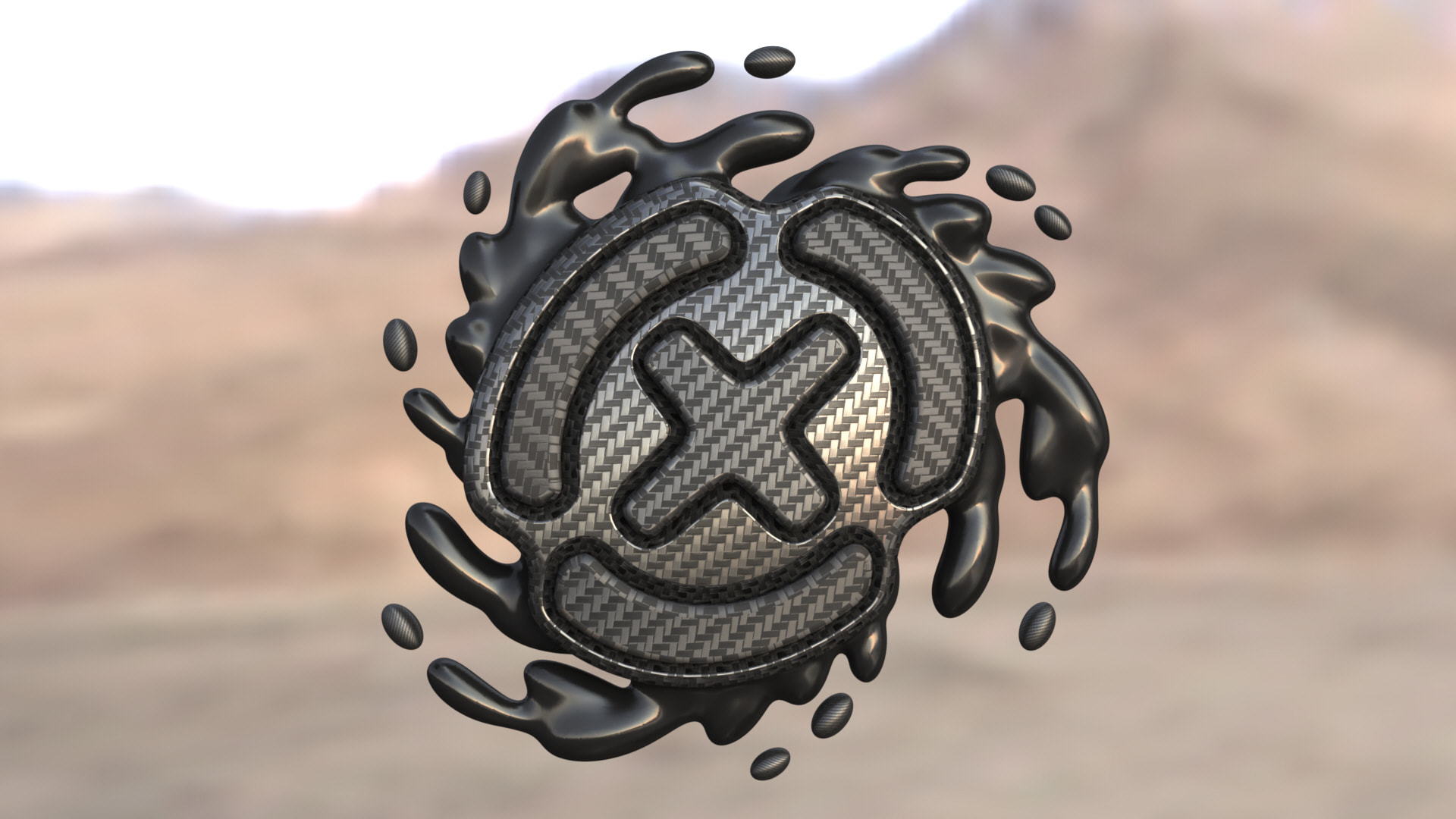

Years ago I did some stickers for our brand. Riffing on an old skateboard wheel sticker.
made some spheres, rebuilt them to a higher UV density, stretched them out, bent them or flowed them, positioned them radially. Probably exported to 3DCoat and smoothed the mass and back into Rhino for rendering. The shrinkwrap inside Rhino will get you 90% of the way there now.
flatter spline shape as I recall.
Very nice! How did you create those nice cartoonesque color shadings?
Cannot recall exactly, been 12 years :slight_smile:
Likely some part was from layering in photo processing program, perhaps a weighting of the outline with another density map to get the unevenness. There was something as well with a black ring reflection of some custom environment map. I remember taking several approaches. Was going after the outlined look of the original.
SubD and shrinkwrap all day.
paperdoll model your shapes with one center edge so you can control the crown of the part, and then simply extrude the edges back in space.
pile a bunch of them together make a surface to close up the back and shrinkwrap the result for a printable mesh
no need for watertight bits, they just need to overlap to make a closed overlapping external volume for shrinkwrap to do it’s thing… this way you keep the bits untrimmed and separate so you can rearrange them and make a new part with different drips.
yes :heart: for sure this is the fastes and straight forward approach.
… not sure if shrinkwrap is needed though. - check your slicer / 3d Printer - many new slicers will handle overlapping volumes.
instead of shrinkwrap you can also bring together the subd 's by:
_toMesh
_meshBooleanUnion
or
_toNurbs
_booleanUnion
