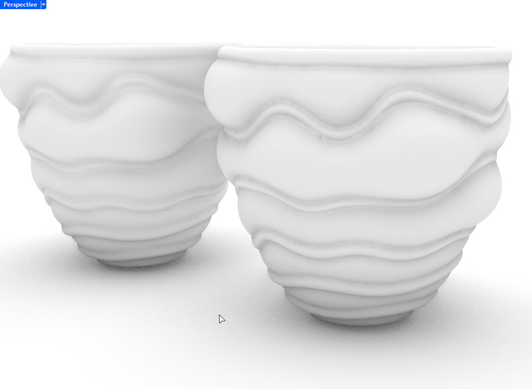

How to make this shape?
This planter is about 5 feet tall and appears to be made from some sort of cast resin. I thought it would make a good basis for some 3D printed parts, but I can’t figure out how to get the same surface curvatures.
I tried SDiffing a variable radius pipe, but that didn’t work well. I tried making a Loft from a series of varying radius circles, but that didn’t look right either. Plus, depending on difference between the large and small circles, SDiff sometimes just failed to work.

I would probably construct the wobbly contour lines, then mesh loft them, and finally use them as anchors for nearest vertices of the mesh in a Kangaroo shrink wrap or mesh relaxation simulation to get the final effect.
Scan it :smiling_face_with_sunglasses:
This is definitely not a Solid workflow. It is more of a surfacing exercise and in this case, Grasshopper is more suitable if you are looking for iterations.
Also if you like sculpting, Subd will be your most efficient workflow,
Thanks for all the ideas. To me it looked like a simple barrel shape from which was subtracted a wavy coil/helix followed by some sort of corner/edge smoothing process.
Diff-arch: interesting idea about constructing the outer edge first and then filling it in. But as someone who used to work in an aerospace Loft dept. I have no idea what a mesh Loft is. :cry:. I do get your point about final smoothing though - I quickly became aware of the need for that.

But the image you posted looks like a good start. Is it a spiral though? At first I thought the real planter was a series rings, but then I went to a different one and was able see it’s really a spiral.
this could be a non-spiral sort of inspiration sketch :slight_smile:
loft-sections-vase.gh (14.6 KB)
on a second thought, scale_nu should also come from a range + path mapper in such a way to give some more movement, like:
loft-sections-vase_2.gh (18.5 KB)
and probably you could also range+graph also the domain of the Z random movement of the circle points in such a way to drive it better (expecially set it to zero for the base -which should be flat)

Using Kangaroo pressure could be also one way
Make a fine mesh, some curves
inflate mesh spiral.gh (1.0 MB)
And adding some pipes, then shrinkwrap
Inno: That looks quite good to me - I’ll have to decide how impotant it is to have a single spiral compared to parallel rings. Thanks.
Laurent: needless to say your GH skills are miles ahead of me - it will be interesting to see if I can do some quick catchup. Thanks.
Inspiration indeed! It took me a while but I did what amounts to a major rework for your GH file and have got this as my first result:
I realized I needed to make some serious changes to your GH file when I discovered that I could not find a way to make a single Closed Brep from your final result. This is probably because you used several GH component I’ve never used before (Relative Item, Unflatten), and also because I share David’s disdain for GraphMappers, even though I have used them before. My GH file is a huge mess right now, but here’s the final geometry shown above if you want to take a closer look at it.
ClosedBrep.gh (114.7 KB)
I tried a 5-pointed star shape instead of a circle for the basic cross section, but this just looked weird, so the circle is it for now. I’ll be back at my home base next week so I hope to be able to make some more progress then. Thanks again for your help with this.
Hey inno - just wanted to let you know I finally figured it out. 2 spirals tweaked by your method and then lofted. I need to make sure the result will slice OK, but I’m quite sure I’ll find settings that do that. Thanks again for your help.
